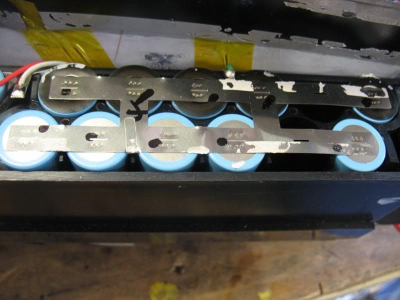

Post by deepfraught » Mar 21 2013 12:19am
No info yet, it's a blank canvas so I'll be looking into slick OEM style battery/charging workflows for home/office quiet and convenient like standard setup. A switchable controller upgrade for 36V or 72V config at same time as switchable battery wiring would be ideal for range or power. Or run 72V "get to work" in rear battery and 36V "get me home, emergency" in frame battery.
Here's the batteries arrived yesterday, all within 0.1V on multimeter (I forget the voltage, fell asleep sitting with a probe/battery in my hand)
History: Front hub SS 200W, China E-mtb 200W, 3x A2B Metros, Commuter Booster beta, 2.4kW d/s w/DD kit, MAC 1.5kW road/flatbar 1250Wh EM3EV frame batt, BBS02 750W d/s MTB 1250Wh frame batt. All sold (except A2B Metros pending TLC from storage).

Post by deepfraught » Mar 22 2013 4:30am
I am hoping to run less than 50V on stock setup like YPedal, in 12S7P with 14 of 15 in pic, only modify when stock controller fails

I've had a good read of this thread as I have been asked to replace the B battery on the rack of an Australia delivered A2B.
It's nice to see a few extra volts is fine for the internal controller as I am planning on using a 12S A1213 20ah pack from Cellman as the rear battery replacement.
I would like to keep the original A pack/B pack key switch function instead of plugging the new 20ah pack straight into the motor.
This is where my question starts. The original B battery has 4 wires that connect to the bike, red +, black - and two thin wires orange and yellow. These 4 wires are together in some sort of XLR plug.
What are the orange and yellow for. They go to the BMS inside the pack, see the first photo in The Stig's earlier post. http://endless-sphere.com/forums/viewto ... 78#p511018
I haven't got the bike ATM just the rear batt pack so any help is much appreciated.
The metro wiring diagram I found here on ES doesn't show the orange and yellow wires connecting to the rear battery it only shows a red and black.
http://site.nycewheels.com/manuals/Ultr ... ual-V1.pdf

Matt I haven't got to fiddling with mine yet, but do look at the batteries daily as a reminder so may follow in parallel.
PS: If the owner you're doing it for wants to get rid of the factory B-pack, I've now got 3 x A2B chassis but only 2 x rear packs to work with, and am keen to add a 3rd ;)
