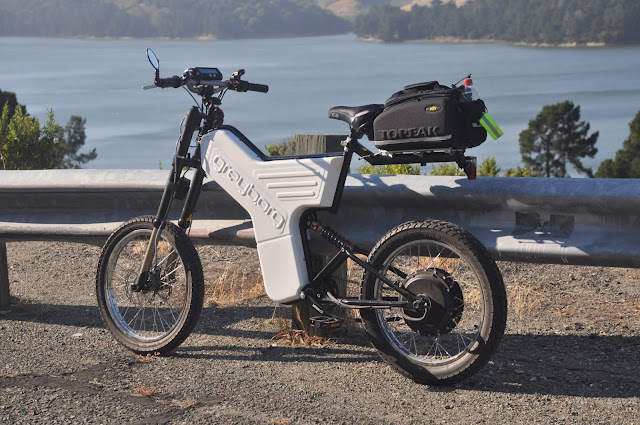

35 mph? No Problem, this commuter ebike soaks it up:
Greyborg Warp frame
17" Moped rims and 2.5-3" Gazelle tires
Cromotor
18S Lipo 70 volts 20 amp hours
12 FET Lyen controller (24 FET is being repaired, this is the backup)
Dual 160mm 4 pot front Gatorbrakes
DNM Volcano front forks
Yasusu rear shock
Cloud9 seat
Mirrycle side view mirror
Rear brake coming soon (regen works too)
