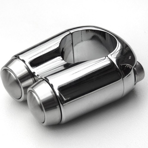

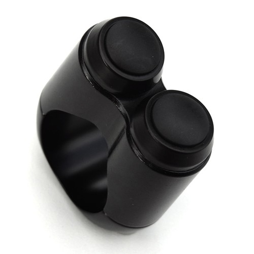

I like these momentary switches for motocycles, they're not exactly cheap, though:
http://www.ebay.de/itm/Motogadget-m-swi ... 1170770489
http://www.ebay.de/itm/Schwarzer-Alumin ... SwT6pV0sD-
http://www.ebay.de/itm/Chrom-Aluminium- ... Sw14xWQ3Oi

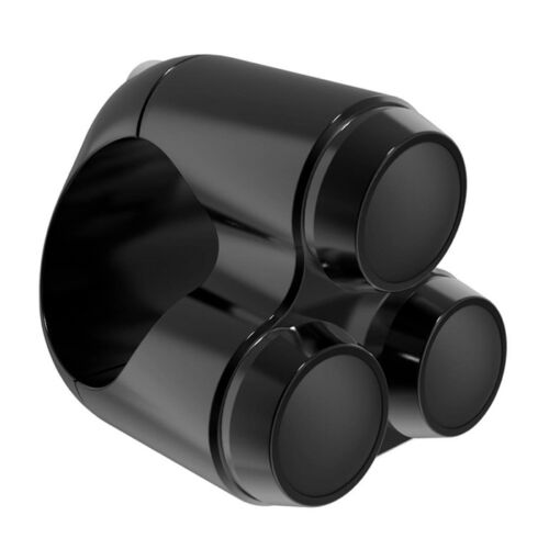

There is even a three-switch version available:
http://www.ebay.de/itm/Schwarzer-Alumin ... SwdG9XRT1b
Just browse through 'motocycle switch' from the 'expensive side' down at your local Ebay.
