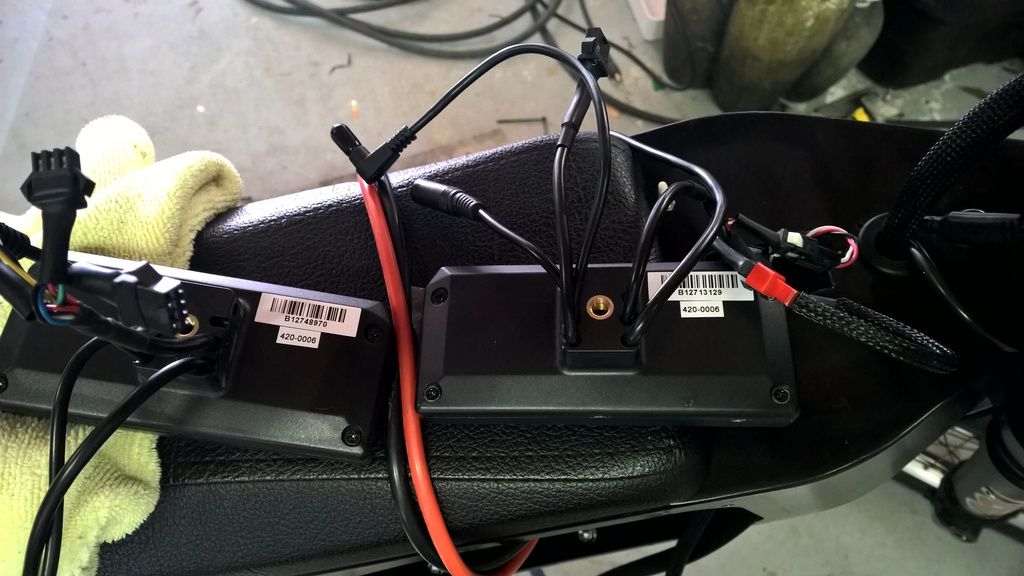

I installed another CA3 and now the issue pop up a lot quicker.
The one on the right is the new one

Okay - so the screens are not just scrolling by, they're changing left or right only on a high current spike when you goose the throttle.
This looks to me like a noise issue, but a few questions:
If I understand the previous post correctly, this really doesn't have anything to do with 3.0, but happens with older firmware as well, correct?
What older firmware did you try?
Is it true this recently suddenly started happening, but there have been no changes to the bike at all?

Post by snellemin » Feb 27 2016 4:20pm
This started when I changed the down and up rate of the throttle. Before that it was fine. No hardware changes to the bike has been made. The last beta firmware was used. I will install an older setting and tone down the Sabvoton as well. I'll report back soon enough.

snellemin wrote:This started when I changed the down and up rate of the throttle. Before that it was fine.
Okay.
Which way did you adjust the UpRate (larger or smaller numeric value?)
Are you using either an external shunt or a CA-DP connector that you wired into the controller yourself?
(Ya - I know this sounds like 20 questions, but remote stuff can be a little drawn out...)

Post by snellemin » Feb 27 2016 5:33pm
I'm using an external shunt.
I triple checked all my wiring, disconnected the temps sensor, limiter switch, toned down the controller and reflashed the CA a few times already. I didn't even use my settings, just the default settings of the CA. So no throttle tweaking at all. Same results.
Are you thinking it could be my shunt connections?
Silent speed Racer

Post by teklektik » Feb 27 2016 5:50pm
snellemin wrote:I'm using an external shunt.
Ya. It sounds like you've been pretty thorough about running down possibilities.
I'm thinking (hoping) this is a ground reference/ground loop issue.
  • Is your main CA ground (black wire on the CA_DP cable) tied to the battery or to the controller side of the shunt?
  • Do you have any other grounds from the CA hooked up (throttle, ebrake, temp sensor, etc)?
Main CA ground is on the controller side of the shunt.
I even disconnected all other grounds and with the same negative results. Kinda lost here. I'm going to have to physically disassemble everything tomorrow and go from there.

  • You mentioned a low-voltage LED - is this flashing all the time when the throttle is hooked to the CA?
  • Does it have a power or any other switch?
  • What are the individual cable connections and which ones are you moving to the CA throttle connector?
  • Do you have a DMM?

Yes its a combination throttle the common ORO cyclone throttle for Kelly controller with on/off switch and LED voltage indications.
yeah I don't have on hand a plane throttle, I also need to keep a switch to enable the controller Positive.
the red low voltage LED flashes when I switch the throttle switch off , which is unusually as this only shows when I have the 3 throttle wires running through the CA, i.e ground, 5v+ and throttle signal. When I run these 3 wires direct to the controller when I switch it off ALL LEd's on the display switch of so their is no flashing red low voltage led. These 3 wires are the only ones I swap. The other wires is Battery full voltage and 2 other heat cutoff wires so think they are unrelated. But yeah when I have switch off and red LED flashes the CA v3 backlight also flashes in the same pulse.
it's weird because the throttle works fine except I can't see to get full power or the display doesn't show full power with through the CA ? Also when I put the throttle on their is a small change in the voltage the CA shows on the screen, i.e 0.71 goes to 0.73v when the throttle is on but twisted fully off, is that unusual ?
I tried one more thing which is change the Kelly max input to 60% from 80% so if for some reason I couldn't get enough voltage at full throttle then it should fix it. nope no difference... I am now wondering if their is a change in the display time and I just missing it but why when I wire those 3 wires I can see the current spikes and double the power? the butt Dyno I can't tell but I think it does feel like half the power when I run through the CA.
Yes I have a DMM.

Nathan wrote:...the red low voltage LED flashes when I switch the throttle switch off...
Although there are some posts on ES about this throttle, there are no details about how it is actually wired. There is reference to a PIC processor in there which I assume is running off the +5V supply. When you hook the 'throttle' wires to the CA I think you are powering the PIC processor from the CA.
Nathan wrote:These 3 wires are the only ones I swap. The other wires is Battery full voltage and 2 other heat cutoff wires so think they are unrelated. But yeah when I have switch off and red LED flashes the CA v3 backlight also flashes in the same pulse.
I doubt those are temp sensor wires on the throttle connector - probably ebrake. Here are a couple of threads and a couple of snaps from those threads:
Lyen 18fet to Cyclone 1000watt Instructions
Headline Motor & Cycle Analyst with limit functions
Frankly, there does not appear to be a return to the controller for either Vbatt or +5V -- so the switch cannot reasonably be switching Vbatt as it does with other controllers and cannot be switching 5V back to the controller either. The Vbatt connection appears only to be used for the fairly worthless gas gauge LEDs.
So how does this thing work? Oddly, both of the images above suggest that the throttle on/off switch actually controls the power for the throttle electronics - which apparently kills the throttle signal but does not actually power down the controller - again, kind of worthless. On the other hand, if the switch actually does interrupt Vbatt, then it makes sense that the CA-powered throttle electronics would flash the LED when the controller power went away. (?)
So - something is wrong either with those illustrations or guesses as to how this thing works.
The operative word here is 'Guesses'...
Anyhow, if the illustrations above are sort of true, it appears that some bit of throttle electronics and the LEDs are drawing power from the CA throttle +5V supply and that is what is causing the change in the CA backlight when the LED blinks.
  • I assume you have the green CA-DP ThrOut breakout cable connection to the controller ThrIn when you have the throttle hooked to the CA. Measure the voltage at that connection and verify that it is actually as shown on the diagnostic OUT field at full throttle.
  • Also verify that the OUT field shows the max configured throttle out voltage when you are riding at WOT and not getting full power.
If the voltage in the OUT field is correct and the measured voltage at the controller throttle connection tracks the CA OUT reading, then the CA is working correctly and there is some other controller or wiring issue in play. There is nothing more that can be done but to deliver the proper throttle voltage to the controller...
  • Again - guessing at what the throttle is doing, I would recommend disconnecting it completely from the controller when it's hooked to the CA. At the least this will get the menacing-sounding Vbatt away from the CA throttle connections. If the controller won't operate, then we will be pretty certain that the wiring in the illustrations above is incorrect. At that point you are either going to need some additional information on that throttle or start figuring out what the throttle connections to the controller are really doing.
Kelly doesn't supply throttles that I'm aware of, so I'm guessing your throttle came with a kit and was probably fitted with appropriate connectors for that application. The Kellys that I have looked at have wiring for throttle micro-switches but nothing like this throttle seems to provide. If you really want to use this throttle, you may have to disassemble the throttle and figure out what's going on in there. Whatever it is, The LED indicators are not useful and disabling them would not be a loss and would get the Vbatt away from the throttle connections (water in there = Vbatt into CA throttle circuit = very bad).

Justin got back and observed that they have seen this weird button behavior in the past when the button cables had been extended on high power systems. His feeling is that the same noise susceptibility is a work here even though your buttons are stock. The remedy is the standard gimmick of adding some bypass capacitors. The caps will leave the DC levels unaffected and will effectively short out and suppress (AC) noise spikes.
Here you want to bypass the button inputs to Gnd -- the button connector pins are a good place to hook up the extra caps. The center connector pin is Gnd so jump a cap across pins 1+2 and another across pins 2+3. The annoying part is going to be finding a cap value that does the job. Something in the 0.005uf to 0.1uf range should do it. I'd use the small monolithic ceramic caps (multilayer chip caps- MLCC). Remembering that parallel caps add the capacitance and series divides it, you should be able to pick up a several of a few values and cover quite a range for experimentation. If you're lucky you'll just end up with one or two across the pins - otherwise you may need to re-order the final empirically-determined value to get a tidy fit on the PCB.
It's likely that bypassing the power pads on the PCB where the CA-DP cable comes in would also be effective since your issue looks to be noise coming in on the power leads, but since that's a messier tacking job, the buttons are giving the problem, and the button connector is robust and readily accessible, I'd go for the button bypass. You can always resort to the power leads if the easier button solution isn't effective.

snellemin wrote: Main CA ground is on the controller side of the shunt.
Good sleuthing - exactly what I was going to recommend next - but disappointing it didn't turn up a smoking gun. I had high hopes for the ground issue...
So - here's the thing - I'm on the CA technical staff but Justin has years of experience tracking down wacky CA hardware issues. I can make some standard suggestions, but I think we are better off going to specific remedies that he has found effective in the past.
Justin has been deeply involved in moving the shop and is now going to be traveling for a week or so, but I pinged him about this to see if he can bang out some thoughts before he gets back.
So - last couple of points to get as much detail as possible on the table:
  • What's your battery operating voltage?
  • What do you have hooked up to the CA as accessories or controls (throttle, 3-position switch, etc.)?
  • What kind of throttle do you have? (hall/5K resistive/etc)
Battery is 18s Lipo.
Hall throttle.
