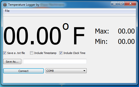

Just to let you guys know I've posted a windows program for displaying and datalogging the telemetry for the cycle analyst. you can find it here:
https://github.com/Bartimaeus-/Cycle_Dash_for_Windows
To run the program you just have to download the .zip file and extract it anywhere and run the Cycle_Dash.exe file.
There should be more discussion for it here: http://endless-sphere.com/forums/viewto ... 4&start=15
Feedback would be stupendous.

Post by hjns » Dec 08 2012 4:31pm
Hi Bartimeus,
I downloaded and looked at the dashboard. Looks nice. However, at this moment it is of little use to me, because it needs my computer. I rather use the cycle analogger, which also captures all other parameters, and adds some nice NMEA GPS data plus 2 thermistor inputs.
I think that at this moment, it is nice for people without analogger to do some bench testing. I do not think any one is going to bring a laptop on the trails. As soon as your endeavors include wireless telemetry with multiple temp sensors, I think most ES hotrodders will be all over you.

Well, I haven't done anything with *multiple* temp sensors, and I wasn't going to post this because I didn't think anyone would be interested, but I made a simple temperature logger based on the code for the Cycle Dash as extra credit for one of my college classes:
It wouldn't be too difficult to add a feature to support as many additional inputs as you wanted for the program. The user would simply be directed to "add another data element", and assign their own labels/units. And from there support for saving templates would follow. Then you could have any type of sensor you wanted working with the program.
At this point I'm going to focus on the software side of things and make it so it can be compatible with whatever hardware you want to come up with. There's definitely limits to a computer based program like this, which is why I'm also working on an Android app. And for people like me who would ride their ebike for commuting and need to bring their laptop anyway this could be a nice way to save ~$150.
It would also be possible to retrieve the data live from the Cycle Analogger if Justin wanted to have it print out the data over TTL when it goes to store to the micro SD card. Obviously you could just use the micro sd card slot, but that doesn't really help much for wireless telemetry ;)
