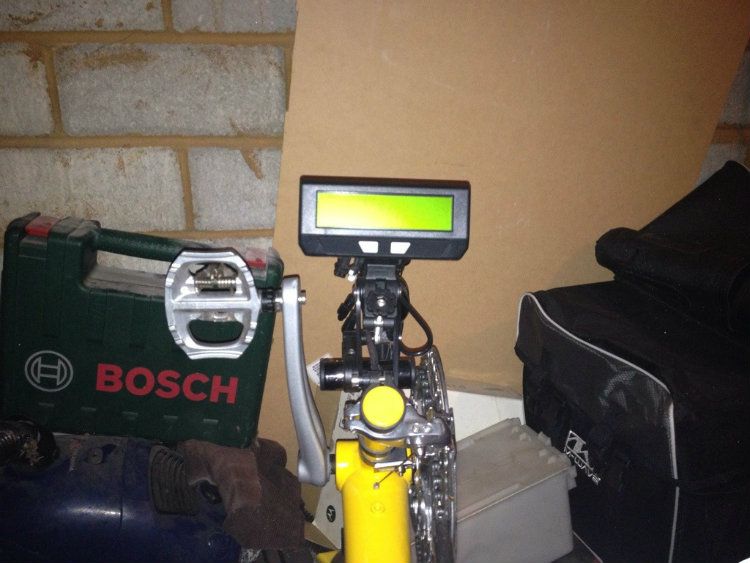

once again, excellent customer service from Justin and crew..
ordered my V3 on the December 20th late in the night, and it's here on the 28th !
can't wait to get it hooked up and running. its just lightly clamped in place at the moment,
but this is where it will live once it's set up. it clears the cranks with ease.
Jason.

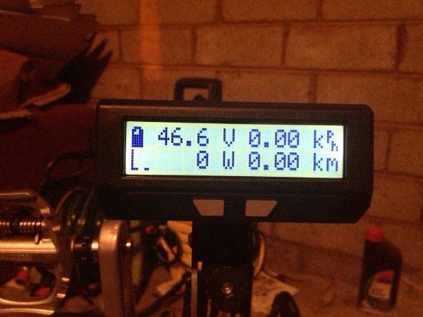

got my CA V3 on Friday, the shop im intending to have install it all is closed. (till early January)
today i tried a basic hook up just to test and see if it would work well with the DP plug.
i plugged in the DP plug and raised the rear wheel off the ground, plugged it in. the CA powered up fine,
then quickly turned off. turns out i had a bad solder join on one of my series leads, and the negative wire just fell off.....
10 minutes later with that re-soldered, back to the garage 2nd try.
CA powered up fine, rear wheel remained motionless, so looks like im good to go with my current DP plug, even though
it was for the older V2 CA's, the V3 works ok and does not drive the throttle high immediately.
i left the throttle plugged into the controller, not the CA. i set the current shunt value, battery chemistry and cell count.
set power limits (20A and 1000W). then i opened the throttle, and at full throttle i get only about 180W power.
unplug the DP plug, and back to the regular power.
after confirming that my DP plug works well, im going to leave the rest to the experts to hook up.
quick question though....
the throttle will be connected to the CA in final setup. is there any other connection form the CA to the throttle on the controller,
apart from the DP plug ?
if yes, ill need a long throttle extension.
as it is, ill need to get a DP extension cable.
Jason.

thanks for the info, i just spent some more time in the garage and it's working in pass thru mode at the moment.
i still need a DP extention, maybe 15cm's or so.... don't want to buy the 2 foot one from ebikes.ca, as it's way too long for what i need,
and i don't want to have excess wiring just bundled about if possible.
one thing i found strange (at first) once the throttle was plugged into the CA, i had a 6-7w power and the wheel was slowly turning with no input on the throttle.
using the diag screens, i was able to see that my throttle was putting out 0.83V even at zero input !
i changed the minimum out on the ca to 0.65v, and the problem went away.
i also noticed that here is a large dead band in the middle of the throttle where no change happens.
guess this is normal behavior of most hall throttles.....
now all i need is to get a bike shop to install the BB for me, and i can muck about getting the assist mode running.
many thanks to teklektik for the very valuable setup notes.
i printed most of them out and took them to the garage while setting it up.
im sure it made the job much easier than it would have otherwise been.
Jason.
Ignorance can be solved, stupid is forever
