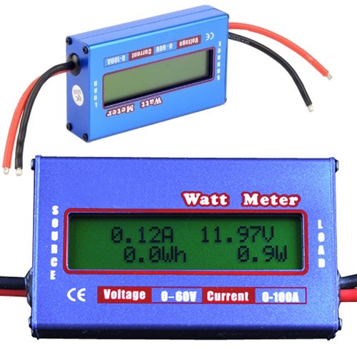

Hi guys. Good to hear you talking about efficiencies / range and how it is affected by different riders and gear setups. The most effective way to measure efficiency is with one of these gizmos http://www.ebay.com.au/itm/OZ-Electric- ... 3641.l6368 Its a Sydney seller so if you guys are keen I can grab a couple, fit some Andersons and get them to you at cost price. Then you can start measuring wh per km and report back. I can then compare back to one of the newer packs..
By the way the majority of the frame battery BMS will not handle the 8a that the Satiator is capable of! Please don't go over 5a for the sake of the cells, the BMS and the connectors!
Riding LMX Freeride and eMax Edi 27.5 Prototype
eMax eBikes - Australian Based Electric Bike Sales & R&D
byebyepetrol
Posts: 230
Joined: Dec 11, 2013 4:19 am
Location: Tasmania
Re: Bafang BBS01 350w vs Dillenger 250w front hub
Post by byebyepetrol » May 11, 2015 3:50 pm
Hi Ewan,
Thanks for the heads-up on these. Any idea of size?
[edit] Size:8.4cm x 5.0cm x 2cm

I guess my question is should I be running the battery a fair way down (yesterday was also a demonic headwind so it was probably the toughest conditions on the battery) over two days or topping it up each night? I reckon hilly rides are making the huge difference here. What sort of gain over 39k are you guys calling "hilly"?
Those volt meters look cool, but I am just wondering where the hell I'd mount it!

Scotty T wrote: I guess my question is should I be running the battery a fair way down (yesterday was also a demonic headwind so it was probably the toughest conditions on the battery) over two days or topping it up each night? I reckon hilly rides are making the huge difference here. What sort of gain over 39k are you guys calling "hilly"?
Hi Scotty. Was a decent brew and pub lunch that's for sure. Glad you sorted out the connectors and PAS location. It's not really about how often you charge, more about what level you charge to and how you store the battery when not being used. The best practice would be to keep the battery between 20% and 80% charge. The BMS will cut the power at around 10% but its the 80% charge which can be a bit trickier to figure out. One method is to time the charge from BMS cutoff to charger cutoff then use deduction to see how long the 80% charge will take. The cheapest and easiest option then is to use a timer on your powerpoint to cut power around the 80% mark. Another option is the Satiator chargers. You can set 80% charge cycles and also the rate of charge.
The little volt meters will be handy for figuring how many watt hours you use on your commute and using the total capacity of the pack to determine how many commutes you can fit into a single charge.

I'd be in for one of those meters too with connectors fitted by you. Maybe won't even permanent mount, just to geek out a bit now and then, see how much more power I am putting in as I get fitter :)

Ewan/Emax, I would also like one of the adapters if it is just plug and play with the Bafang kit with some kind of pass through between the motor and the controller or something.

No worries guys I have ordered the watt meters will let you know when they are ready. No obligation but good to have a few in stock.
