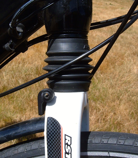

Another slightly unusual feature of this bike is the front shock. It's a single shock, above where the forks split (there's a bit of a fork gaiter over it). I'm not sure exactly how it works, but it works just fine - it absorbs moderate bumps just fine. It's not a long stroke, but it's enough.
Most likely, it's basically just a spring between the bottom headset bearing race position (though actually pressing on a separate part of the steerer tube itself, the outer one, with an inner one sliding inside that like a fork leg) and the top of the fork crown's steerer tube mount, more or less. I haven't had one to take apart, so don't know the exact details, just seen one without the accordion cover (rotted away, probably), on a random bike at a lockup. It may have a damper inside too, dunno. Seemed to work more or less like a seatpost shock. Dunno if it had any adjustments; I didn't want to mess with a bike that wasn't mine.
It's probably something simple. There are no adjustments I can find, but it works decently enough. I'd obviously prefer something nicer, but on a $2000-ish bike, it's better than nothing.
