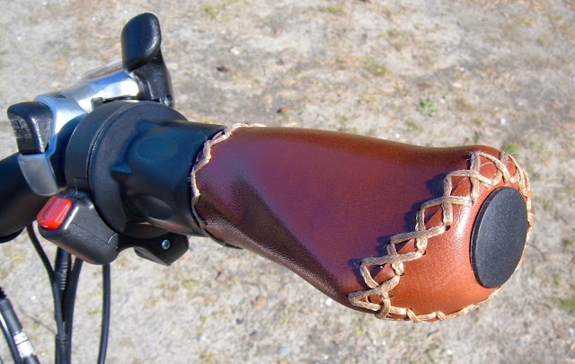

Handlebar Grips
I'm not sure what, exactly, they're made of. But I do know they're beautiful, and they're most unusual.
The grips are sewn together with a thick thread, in a very distinctive pattern.
I can't say I noticed a difference when I was riding, but they do look amazing, and they stand out as something very unique!
And, they match the seat!
