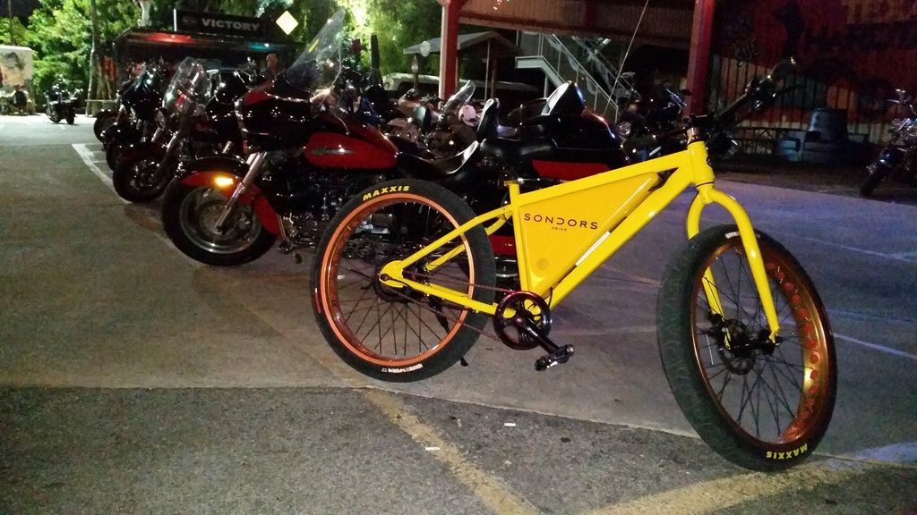

This is my lightly modified Storm fatty otherwise known as a Sondors eBike.
Storm's are decent bikes in stock form especially considering the price, but what makes them different from most other factory bikes are 2 main things. 1. how easy they are to customize, and 2. the gigantic following they have on their private Facebook Owners Group. My bike does 27 mph without pedaling, and at that speed has 40 mile range. Of course I like to pedal, and you can't ride 40 miles at top speed in town so my range is usually around 50 to 70 miles with normal riding. My pedal gearing is tall enough that I can pedal comfortably at top speed. 6th gear for power, and 7th is like overdrive. You could duplicate my bike for less than $2000 which includes the cost of the bike, shipping, plus all the extra parts I've added. Probably the best part is you don't have to be an eBike rocket scientist to build this, because most of it is plug and play, but it's just challenging enough to make it fun.
These are some of the modifications I made to my bike to suit my riding style. I live in Dallas which is a huge sprawling metroplex, so I need a lot of range to get anywhere. It's 20 miles to downtown from my neighborhood so one of my first changes was a bigger battery. A Storm is a great bike for adding a big battery to, because of it's unique looking, and functional plastic box located in the frames V. At the same time I upped the voltage from 36 to 48v, and the amp hours from 8.8 to 30.
So far the most satisfying change I made was to swap out the stock 350w motor with a 750w. The 750s are set up for 7 speed freewheels. The overall motor width is only about 3/8" wider which is easy to stretch steel frame drop outs that much. You can run a 25 or 35 amp controller with the 750. The best part is you don't even have to lace the motor in your rim. Just pop the guts of the stock motor out, and slide the 750 into the stock hub. It's takes about 2 minutes, and you're done.

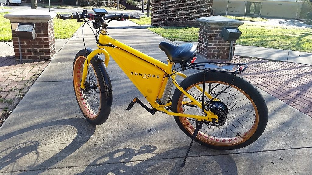

I made my bike a little more perfect with a 18 fet 35 amp controller. With this same configuration I've tried a 25 amp controller, a 35 amp with 12 fet, and a 35 amp with 18 fet. It keeps getting better each time.

What derailleur and shifter did you use when you added the 7-speed?

Scoot440 wrote:That's a sweet bike!
I bought it on eBay.
Shimano Tourney TX35 6/7-Speed Rear Derailleur w/ Hanger
The shifter is a 7 speed grip shift

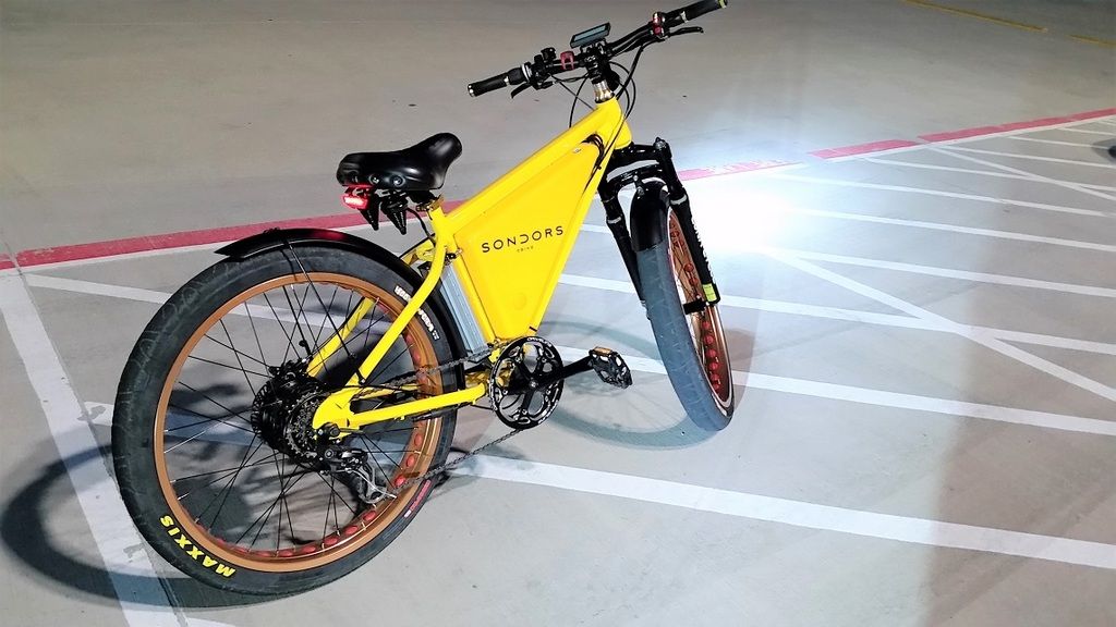

I made my bike a little more perfect with a set of Luna Lander air forks.

Post by Theodore Voltaire » Apr 02, 2017 10:41 am
I decided to dump the rear rack and install new fenders. These are Electra alloy fenders
