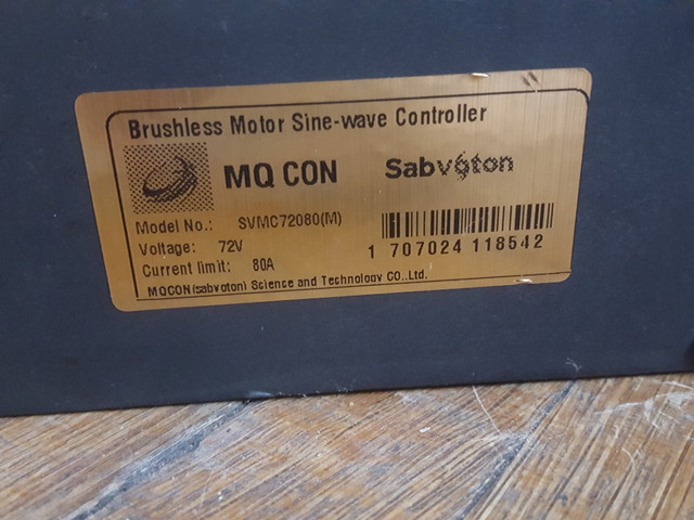

I have a sabvoton svmc 7280 and I'm getting an error code of 30H. Anyone know what this means.
30 h is because the settings lock cable isn't plugged toghter.

Error 30H comes up when communication plug is not joined back together, communication plug is yellow, green, brown, connect to yellow, green, black. I went back to adjust parameters after getting new controller up and running and had issues with app until I realized I had to disconnect these wires again before the app works properly. When I contacted supplier about Error 30H they said it's normal when communication plug is not connected. Hope that helps clarify things...
