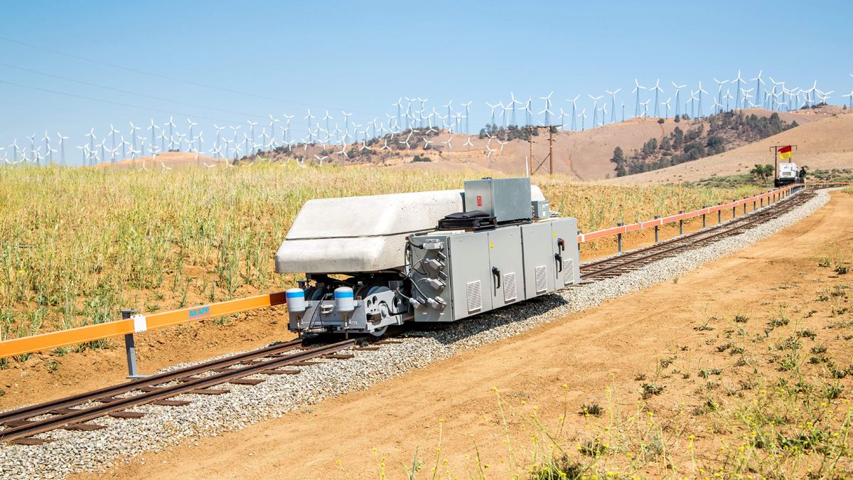

[BURP]... Advanced Rail Energy Storage (ARES) in news again... seen here:
Simple Physics Solutions to Storing Renewable Energy:
http://www.pbs.org/wgbh/nova/next/tech/ ... le-energy/
More than 5,000 miles away from North Rhine-Westphalia, in southern California, there’s buzz about rather plain-looking railcars that don’t transport people or goods or really go anywhere at all. They’re owned by a Santa Barbara-based startup called Advanced Rail Energy Storage (ARES), and they’re another contender in the grid storage market.
When electricity is cheap, ARES electric locomotives draw power from the grid to haul heavy railcars up a hill. Once they’re at the top, the potential energy they embody acts as storage. When the grid needs electricity, the brakes release and the cars begin to inch downhill. The motors that hauled them up turn into generators, controlling the descent and generating power as they go. It’s essentially the same system that recharges the batteries of a Toyota Prius or Tesla Model S when the driver hit the brakes.
ARES has set up a quarter-scale demonstration of its rail energy storage system in Tehachapi, California.

If you haul up 1 million kilograms (2.2Million lbs) up 1,000 meters (3,280ft) above starting elevation, it's 9800MJ or ~2.7MWh.
This just doesn't seem meaningful or worth the hassle to add a bunch of moving parts to do something more efficiently and fit 2.7MWh into a small shed. (3*3 grid of Tesla packs 3 high for 27packs total).

Pumped storage is still so lossy vs batteries, neither seems very appealing when a shallow cycled battery array could be easily scaled to any energy storage needs and can last for multiple decades of daily instant power demand with extremely high efficiency in and out.
Even rail cars with falling weights or water has a power delivery delay as gravity must accelerate either of them to transform the potential gravitational energy into kinetic energy to be then transformed into electricity.
Long term there is no place or need for a centralized distributed grid, just solar roofing on each building and batteries integrated into the basement or batteries composing the walls of the structure.
Short term, bi-directional onboard EV chargers with coms over power lines to load shed and/or grid buffer as needed to eliminate peaker plants seems more useful and less resource intensive than any other grid buffering proposal I've seen yet.
