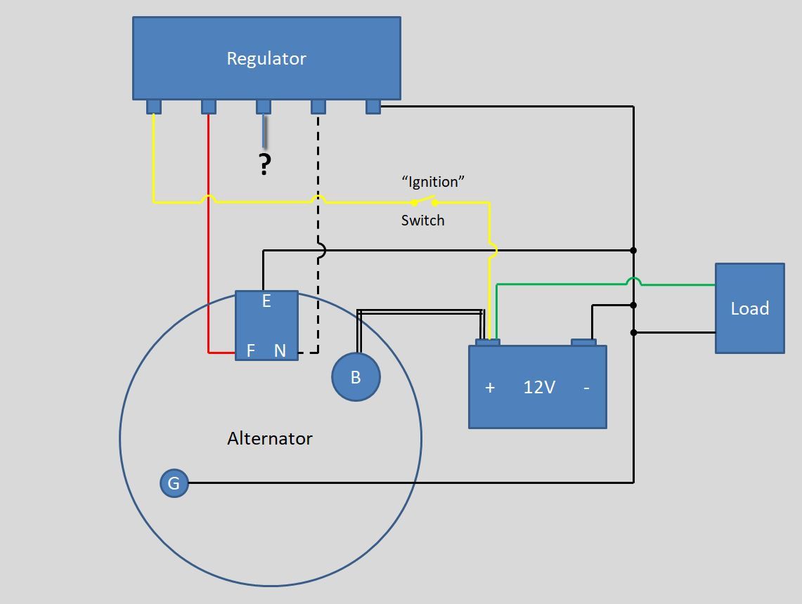

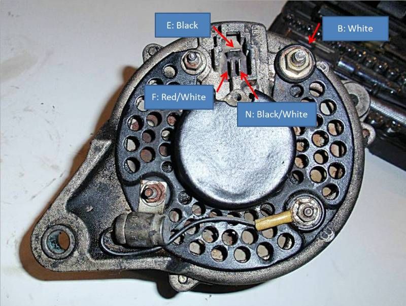

I have an old alternator off a 1981 Civic Wagon. The engine is kaput, but it still has lots of good parts. Like the alternator.
I made a note of each color wire was attached to the alternator before removing it, and also found a wiring diagram so I could identify the function of each connection:
F: field coil +
E: field coil -
B: power coil +
N: power coil -
For anyone who doesn't know, (I sure didn't) alternators don't have permanent magnets in them. So in order to generate a magnetic field, power must be applied to the field coil. This means you have to put power into the alternator to get power out. This took a while to wrap my brain around.
By the way, "field coil" and "power coil" may not be the proper terms for these components. I'm still learning this stuff. But at least they're descriptive, right? Also note, this alternator has no voltage regulator. Second Generation Civics have an external voltage regulator, which I won't be using.

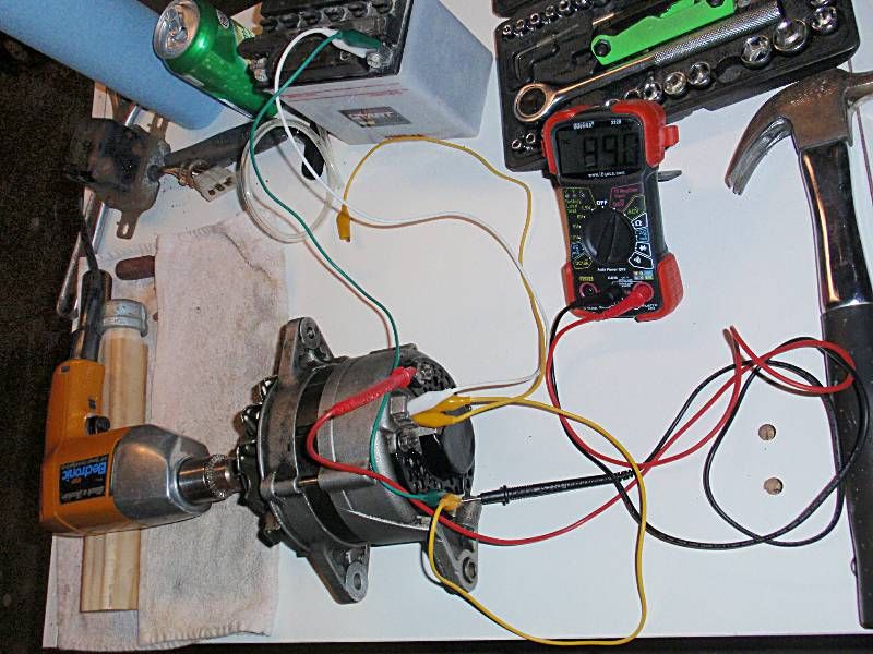

So a 12V battery on the field coil terminals will generate the magnetic field, and a multimeter or light bulb on the power coil terminals will tell me if its working. Also, its seems like a good idea to ground everything to the alternator casing, since that's how it's done in the car. Here's a diagram of how I plan to wire it:
There's a couple features on this diagram that I haven't used yet. The switch to the battery, and the jumper from B (power coil +) to F (field coil +). Those I'll add later to try to make the field self-sustaining. For now I just want to see if I can make it work. Here's my actual wiring:
Well, the wiring is a mess, but I used a motorcycle battery for the field (which drew about 1.5A) and a hand drill to for rotation. It worked! The multimeter read around 15V, and when I hooked a light bulb up to it, nice and bright. Next is to clean it up better and put it on some kind of jig and replace the jumpers with proper wiring. Also, I need to find out at what RPM the alternator is meant to be used, and how many Amps can be safely drawn from it.
Mike

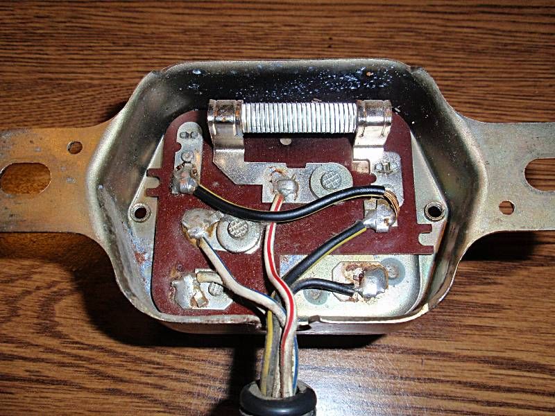

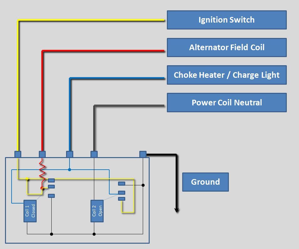

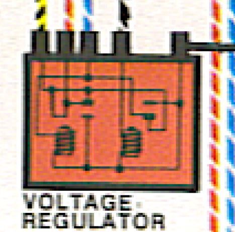

Well, it doesn't look like I can get the rotor apart without breaking it. If I want to experiment with magnets I'll have to make my own shaft and magnet assembly. I'm leaning back towards keeping the original rotor anyway. A fellow from the old Honda Civic forum suggested I use the original external regulator rather than messing with resistors and switches and such. That struck me as a pretty good idea. Although, it means learning how the regulator works so I know how to wire it.
Starting with blowing up the wiring diagram to a horribly blurry size, I took a look at how the internal wiring is done.
I also took a really close look at the actual regulator.
I'm amazed at how clean and new the upper half looks. Anyway, with that stuff to look at, I've come up with what I think is an easier to understand diagram of my own.
It looks like one coil/switch is for the field coil, and the other coil/switch provides power to the first coil/switch.
The first coil/switch operates based on how much voltage there is in the system, and the second coil switch operates based on current returning through the negative back to the power coils.
I think the blue wire is only there for the dashboard warning light. See, the light already has a positive and ground on it, as well as this blue wire. So as long as the second switch is connected to power, voltage across the bulb will be the same, so no current. If the second switch is grounded, now the other wire on the bulb will send current to this new ground through the blue wire. Letting you know that there is no current getting back to the power coils through that coil/switch. That's my best guess anyway.
So with all that figured out, I can add the regulator back onto the alternator and have some nice automated power regulation. Here's what I've come up with for wiring so far:
Well, my parts are all clean and painted up nice, so time to put some of this guess work into practice and see what blows up. :)

I got the alternator and regulator reassembled, and wired according to the diagram I posted earlier.
It works! The battery starts out sending about 1-2A to the field coil, and the voltage sags to around 12.9V (I think this battery is on its way out.) I used a hand drill to spin the alternator up to around 1100 RPM, and the Voltage increased to around 13.1V, and I measured around 0.5-1A heading back into the battery.
On the regulator, the second switch, the one affected by the current to the power coil ground, behaves exactly as it should. The first switch, which regulates current to the field coil, didn't get a chance to perform, as the Voltage never got high enough. But pressing the switch manually, did cause the magnetic field to be reduced. I was able to observe this as a reduction in Voltage, Amps, and rotational resistance.
So I'm pretty pleased with these results! I'm thinking though, that bypassing the 11 Ohm resistor in the regulator will allow more current to flow to the field coil, and allow the alternator to produce more power at lower RPM. Sure, it would turn with more difficulty, but I don't know what kind of RPM's I can expect from attaching it to a bicycle wheel. Well, it won't matter until I get a belt in the mail and a bike set up to run the thing. I read somewhere, that alternators can spin up to 5000 RPM. 1100 certainly doesn't make much more than what's needed to run the coil.
