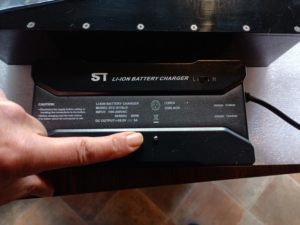

I'm building a solar assisted touring trike & after searching around the webz for a few weeks I decided that the EM3ev 52V (14S7P) Hard Case Rectangular battery was the best (albeit pricey) option. I had several email conversations with Joseph regarding my project including the solar aspect & the ability to change the battery on the go from the solar via the Anderson recharge connectors as shown on their website. Joseph was very knowledgeable & helpful which was a deciding factor for me so I went ahead & ordered one with the dual speed charger for good measure.
After 3 weeks with apparently no tracking change I emailed EM3ev requesting some info on it's whereabouts & they said they would contact the courier & find out. According to a web search, there are at least 2 international airports within a 100km range of the EM3ev address, so it was difficult to imagine why a courier couldn't transfer the parcel to one of them within 3 weeks, so I looked up the courier (DTDC) on TrustPilot out of curiosity & my heart sank - they had the worst reputation I had ever seen for a courier - 1 star, just.
I hadn't heard back from EM3ev so, armed with what I had learned about the courier, I contacted them again via email suggesting that they should consider the parcel missing/lost & we should organise a replacement asap as it was almost a month since the order was shipped. Thankfully, the very next day it turned up in the UK & was delivered the next morning. Phew....I thought, until I unpacked it.

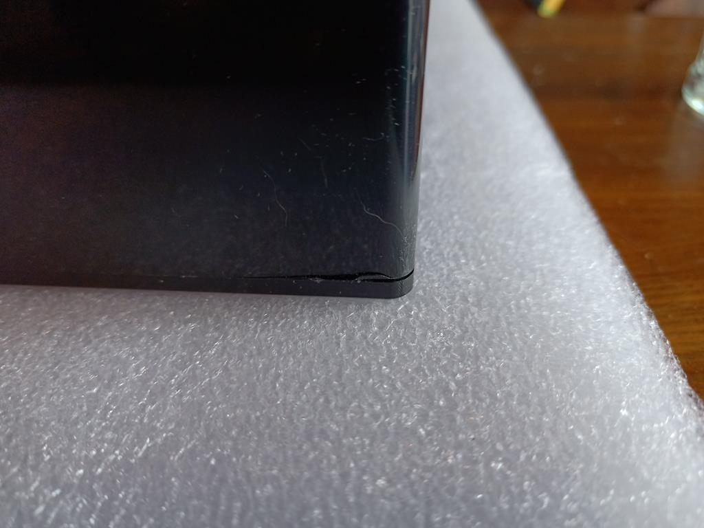

The first thing I noticed was that there was zero documentation included for either the charger or the battery. I presumed I could download them from the "my orders" section of my EM3ev account, but no - nothing available & no links anywhere else to download them. The second thing I noticed was that when lifting out the charger from the well packed box, a disturbing rattle could be heard coming from inside. This was of great concern, it sounded like something had come loose. The third thing I noticed while peeling off the protective layer on the battery was the absence of the Anderson charging cable/connector I eluded to earlier & had discussed with Joseph - it just wasn't there. This meant that the only way I could connect my solar was through a flimsy 3 pin charger plug that isn't available anywhere that I can find in the EU, or I'd have to open up the battery itself & see if I can solder the wires for the Anderson connector myself - both of these options are far from ideal. The next thing I discovered while inspecting the battery was a crack/damage to one of the corners:
Obviously this means any water resistance is gone & the probability of the damage getting worse through vibration, etc is high. So, all things considered, I'm pretty hacked off with this whole experience so far. After waiting a month for delivery I have a charger I'm scared to use & a battery I can't use due to missing connectors & corner/joint damage - plus I can't risk using the charger to charge it of course. I did manage to get the object that was rattling around in the charger out through the fan outlet eventually - it was a piece of solder:
I am however reluctant to try it out in case I damage the battery/charger - plus I can't use the battery anyway, so there's really no point in trying.
Had there been no crack to the battery casing I was prepared to try & solder the required connections myself - which was why I was going to ask the community here for any info on the internals, but finding the crack is the last straw for me I'm afraid. As of now I'm still waiting for a reply from EM3ev to my last email regarding the missing connections, but having discovered the cracked casing in the meantime I feel I have no option but to return the whole lot, so I gave them a call today & got 2 minutes of classical music before being cut off. Three times. No answering machine or anything & it was in office hours in China. Not happy.
So, if anyone here has any contact with anyone at EM3ev I'd really appreciate it if they could contact me/them here, as reaching customer support at EM3ev is just draining. I'd appreciate any input or suggestions from the community here.
Thanks for reading & look forward to hearing from somebody/anybody regarding my experience with EM3ev.

I think ebikes.ca might be the only company i've bought something from where documentation was sent.
We hear complaints about em3ev's customer service being insanely slow to respond every spring.
em3ev's products are good and well designed but i hate to hear they didn't take care of you.
I suspect your battery is fine and just took some damage in shipping and is easily sealed back up.
Returning the battery is probably going to be super expensive and i'd advise you to get your hands on a charge/discharge port adapter instead.
The piece of solder makes the charger the sketchy thing here and that is the thing i'd not use until it is opened and inspected.

I checked the box thoroughly for damage on arrival & after spotting the defects - there is no damage to the box at all & the items were very well packaged with no movement possible. The rattling charger was immediately obvious, but the cracked/damaged case was only noticeable on closer inspection after the protective layer was removed & looks to have been done during assembly in my view. To me it seems to be a QC issue on both charger & battery - but I'm struggling for an excuse for the missing charge connections....
I read on their website that returns are posted to within the UK, so that's not such a problem - the problem is getting hold of support to arrange a replacement which also has the correct leads/connections. I still want a battery from them as I believe they are (usually) of the best quality & I just got a rare bad one, but as you say, customer support is lapse - which is very frustrating after waiting a month & parting with so much cash.

If the battery is fully working and free of construction defects ( likely; em3ev is known for good product quality and engineering ), then you can simply use a $10 adapter or re-solder the existing connectors to make use of it.

Edit: According to the diagram on the charger only 2 of the 3 pins are used (+ & -) - does anyone here know if the 3rd pin is used at all? This is where a schematic/charger manual would come in handy...

You should have gotten a manual for the charger. I'm sure they will email one to you if asked. If I was in your position I would seal the crack with something (hot glue, epoxy, plastic dip) and tape then use it paying attention with a voltmeter for the first few uses. (which needs to be done with all new batteries anyway) Otherwise you'll be waiting a couple months for the replacement.
Same thing with the charger. It's probably OK. With anything from China without proper UL testing, It's up to you to check operation.

I don't think you posted a pic of the connector. If it's an XLR3 connector, then you simply need your DMM and measure them. Two pins will provide battery voltage.
https://i.ebayimg.com/images/g/g-YAAOSw ... -l1600.jpg
Regardless of how many pins there are, only two are used.

Not true I'm afraid. Some batteries (usually good, high end ones) use the 3rd pin as a communications signal, a thermistor for example, or charge control. I've had a couple of batteries/chargers that use the 3rd pin - it's usually there for a reason, although many manufacturers (low end) choose not to use it.
