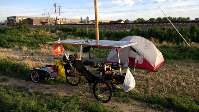

I have done it. Next time the solar panels will be on a trailer.
Kansas to Utah without plugging in.
