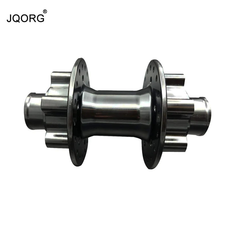

You can see the LR hub in this listing.
http://lightning-rods10.mybigcommerce.c ... -and-140r/
In the recommended parts list is this "165mm billet 6061 wheel hub with 4140 chrome moly axle"
It's the part shown in the last 2 images from that listing. It's not included in the kit. You have to order it separately.
I searched his site and he doesn't list it for some reason, but that's Michael Backus for you. His site hasn't seen an update in quite a few years.
He works with a local machinist who does good work, but orders take a good while to get done.
You don't really need this part as you can work out mounting a sprocket and rotor on the same 6 bolts, but this is a better option.
Thanks. I knew about the qulbix hub; sadly only for fatbikes. LR was kind enough to reply to my inquiry with another link: http://www.damgood.com/cycle.html
This one fits into 135mm dropouts, but the price is ... steep!
LR originally said he was making his hub for various sized drop-outs. I wonder what changed?
Regardless of who you get these custom hubs from, they won't be cheap. This is a limited production, specialty item and they will be fairly expensive as a result. It's not the materials involved, just the production and labor costs that are expensive. Parts like this would be made on a CNC mill and lathe, but only get cheap if they are made by the thousands and they never are more than 10 or 20 at a time.

An finally, I'd need some sort of fixed gear rear wheel. This problem appears to be more tricky than initially thought, as nearly all fixie hubs have thread-on flanges,which would loosen during regen braking. The best I could find is this dual side 6 bolt hub:
But it's expensive, 110mm only and more annoyingly 15 or 20mm Through Axle, while I need a standart M10 or 3/8 bolt on plain axle.
