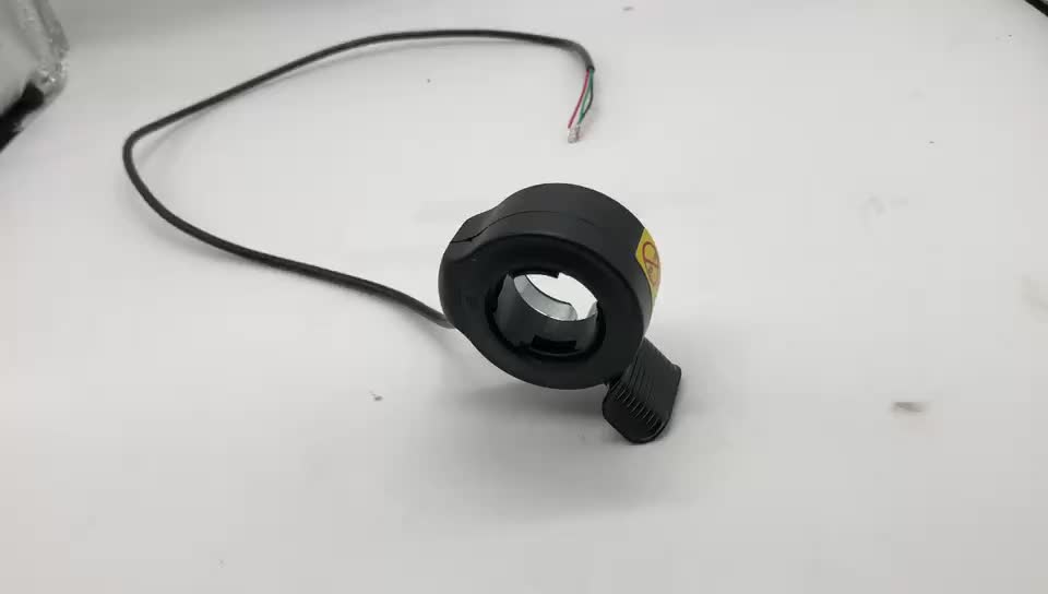

I'm finding the chainrings I have up front are far too small for my pedaling cadence to keep up at 45kph! I'll need to get some bigger chainrings up front, but that's not a huge issue.
The throttle I bought has issues, namely a very narrow range of input. I'm either too slow or full bore. Hard to get any throttle values in between. If anyone knows of a source for a good high-quality no-LED thumb throttle, I'd love to see it.
I also need to install a switch for activating the PAS. You'd think it would be smart to include a button-driven function on the controller LCD display to turn that on and off, but as it is if it's plugged in PAS is on, which is annoying. It's not like you can turn the assist level to 0 and just use the throttle either, as 0 turns off the throttle as well! That's all for now I believe... need to get a headlight system in place and re-adjust brakes/derailleurs a little but that's about it. This one's almost done!
Controller re-positioned into the free radical attachment arm. Not sure if this is permanent yet... probably will do a cover and mounting plate of some sort.

dequinox wrote:
May 03 2021 1:09pm
Is your controller programmable? You may be able to dial in the throttle or otherwise better tune the controller's reaction to it.
Chalo   100 GW
Posts: 8578
Joined: Apr 29 2009 11:29pm
Location: Austin, Texas
Re: Xtracycle Build Log
Post by Chalo » May 04 2021 1:31am
dequinox wrote:
May 03 2021 1:09pm
Are you using the Wuxing 130X throttle?
If so, it's pretty abrupt and insensitive. I've gotten much better feel and definition from the Wuxing 108X paddle type throttle:
Note that the 130X can be used on the left or right, but you have to get the 108X in one version or the other.

Sadly it's not. Just a cheapo brushless, nothing special about it. At least I don't think so...
The throttle didn't become a problem until I switched to the Wuxing 130 Chalo mentions above.

Thanks for the suggestion! Yes, the problem with the 130x (which I didn't know that was until you mentioned it) is that it's dead, then abrupt near the full throttle. I'll give that other model a try.
Chalo wrote:
May 04 2021 1:31am

Purchased a new throttle, the 108X, which should show up later this week.
