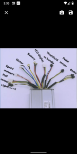

Hi, I'm in Covid 19 lock down here in New Zealand building an ebike. This is my first build so I'm I'm a total newbie. I've built a 4p13s 48v battery that seems to be charging ok.
I bought this kit on Amazon
https://www.amazon.com/JAXPETY-1000W-Electric-Bicycle-Conversion/dp/B07F1FLHC8/ref=cm_cr_arp_d_pl_foot_top?ie=UTF8&th=1
I then decided I would prefer a LCD readout so bought this controller / lcd kit:
https://aliexpress.ru/item/32616948234.html
I have read Micah Toll's ebike book and found this helpful in putting the bits together. However when I completed all the connections and attached the battery I got no LCD startup (screen remains blank) and the throttle does nothing. I'm not quite sure what I've done wrong. Obviously I have had to re-solder connections from the original Contoller kit onto the new LCD controller.
Where might I start with trouble shooting? I'm not even sure my new controller and LCD are compatible with the Amazon rear hub motor.
At this stage I haven't installed the pas sensor since I don't have the tools to install yet. I'm Not sure if this is part of the problem?
Would really appreciate some help sorting this out.

Hi, really thankful for your help with this everyone. So I didn't wire the original controler in until after i'd tried to get the LCD controller to work. I now wish I had started with the original controller which would have given me a easier build.
Anyway, with the battery disconnected I get over 50v instantly. With the Battery connected to the controller I get a very slow increase in voltage from 3v up to over 40 over about 10 minutes. I then tried to switch the LCD on. It blinked momentarily and then went off again. When I retested the voltage I saw the voltage had returned to climbing from 3v.
I'll include some pictures of my setup below so you can see what things look like.. I've also included a picture of the throttle wiring. This was not my first shot at this I tried with the green wire instead of the white wire and when this didn't work I tried some other combinations and this may have wrecked the throttle. Another rooky mistake. wish I had talked to you guys earlier.
that means the battery is protecting itself by shutting it's output off. (it doesn't seem off because there is leakage, but it is off).
that means the system can't power on because it doesn't have any power from the battery.
so your problem is in the battery (there might be other problems in the system itself, but you have to fix the battery first).
the most common problem is an unbalanced battery, where some cells are lower in charge state (voltage) than others, and with a bms that protects based on this, the more full ones cause the bms to stop the charging process before the lower ones get full. and the lower ones cause the bms to stop the discharging process before the fuller ones are empty.
so...the first thing to do is simply leave the battery on the charger at least overnight. if it has a balancing bms, and it is unbalanced now, this will help it charge up more fully. if it is badly unbalanced, it may take days or weeks to fully fix and allow it to fully charge.
if it does not have a balancing bms, this will not fix an unbalanced battery problem, but it will at least let the cells get as full as they can, which might let the battery become operational enough to test the rest of your system.
so...if leavign it on the charger for as long as you can manage doesn't make it usable, we'll have to walk you thru disassembly and testing of it.

Ok, sounds like I drank the kool aid, it's a Vruzend kit.
I pulled the shrink wrap off and measured the voltage strings with low voltage results on string 12 and 13
I then investigated why strings 12 and 13 had such different voltages and discovered that I had swapped the last two red BMS wires by mistake when I built the battery. I swapped them back and have put the battery back on the charger. Not sure if the damage has already been done. Here are the voltage string results after swapping the wires back and before charging. The battery has just gone on the charger now (545pm US time)
the last string has dropped so low in voltage that the cells may be damaged, and could be a risk of fire. i'd recommend replacing them and not charging them. they have essentially been completely shorted out for the whole time that the balance wires were swapped.
unfortunatley you wont' know if they were damaged in a way that could cause a fire until they do so, and it's a little late then.
(they may well appear to charge up normally and operate normally, but have hidden damage inside that you won't find out about until :flame: ) :(
also, if your bms allows the battery to charge with cells that low, then the bms itself is defective (or damaged), because it is there to protect against such things (overdischarge, overcharge, or charging cells that have gone outside the allowable range for safety).
so the charging process should not be working at all right now.
if it is, you should replace the bms at the same time as the cells, preferably with a different brand/model that does correctly protect against unsafe conditions.
