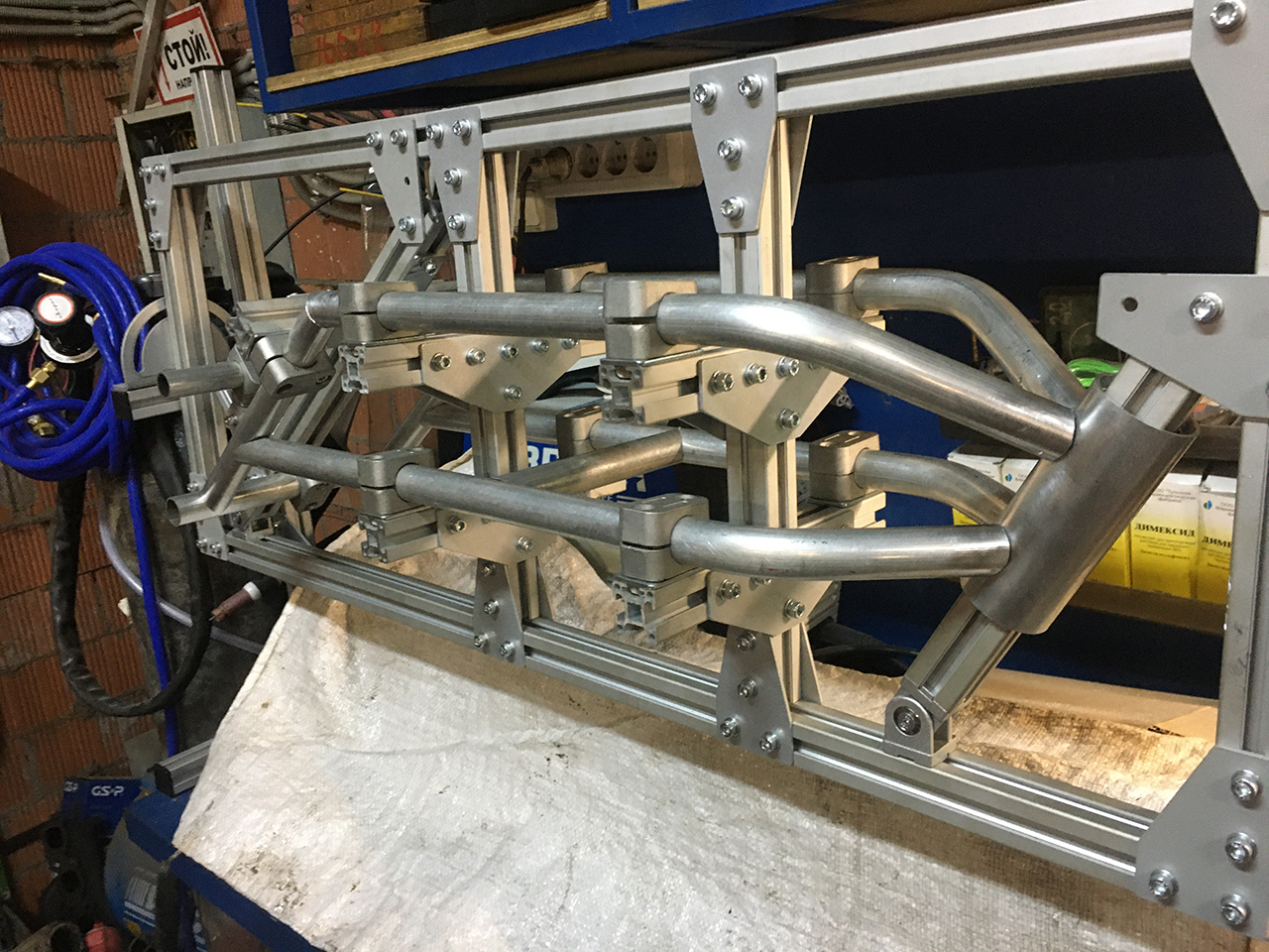

Next step > build the slipway
Kid liked dad's new constructor

Nice work. Love your welding jig!
Ask for it by name.

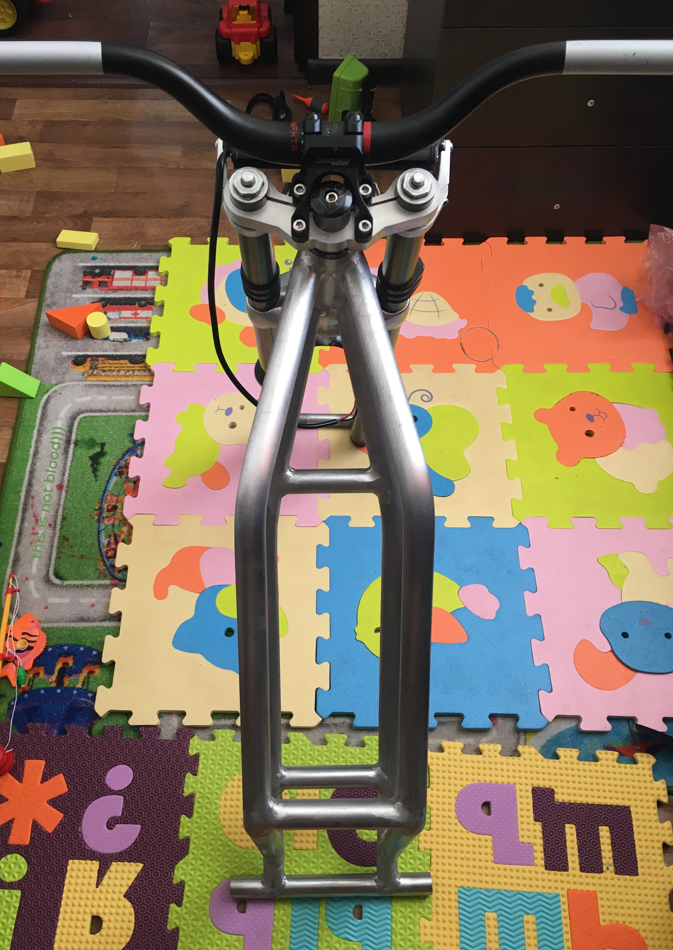

Post by illegalbike » Mar 29 2021 5:29am
semi-finished frame

Post by SlowCo » Mar 30 2021 3:36pm
Nice frame :thumb:

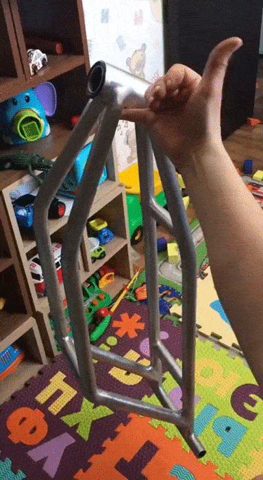

Intersting stuff and amazing metalworking skills. Which alloys are you using ? Any heat treatment planned ?
illegalbike   100 mW
Posts: 47
Joined: Jan 28 2021 12:10pm
Re: Hub motor as mid (illegalbike)
Post by illegalbike » May 19 2021 3:58pm
qwerkus wrote:
May 18 2021 3:54pm
I use aluminum and 5% magnesium alloy, the european name is AMg5, in the west - the 5056 series.
Deformation alloy 5xxx does not require thermal quenching and aging
This is good for frame construction, but too soft for dropouts and clamps - steel amplifier required

The optimal settings for welding 5056 alloy at 60-70 amperes for a thickness of 2 mm and 120 Hz with metal preheating were found. There are about 30 units on the balance (some units differ on different devices)
illegalbike   100 mW
Posts: 47
Post by illegalbike » May 20 2021 4:23am
weight of aluminum frame 3.6 kg (7.9 lbs)
it even surprised me :D
