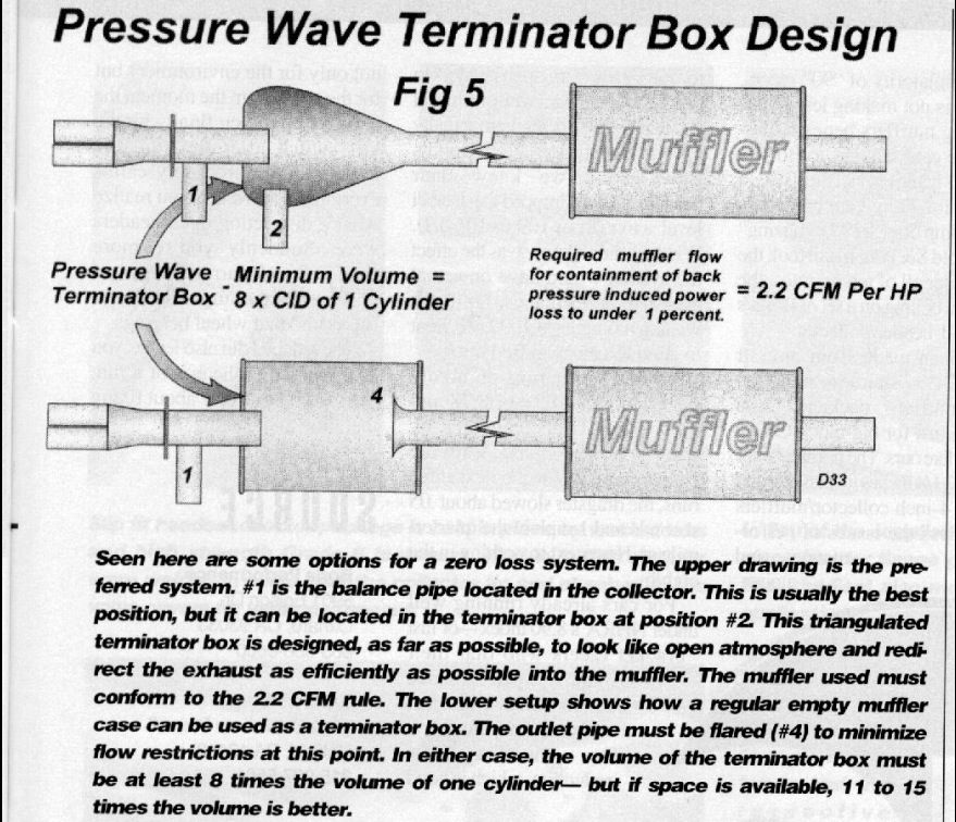

To improve ICE efficiency:
As the ICE runs at a fixed RPM (2 in your case) a tuned length exhaust is the 1st thing I'd try as the stock thing is highly restrictive to fit in a small space.
The maths:
http://mezporting.com/exhaust_length.html
(Similar maths for intake on same site IIRC. NB Bell Mouth. 1/4 the exhaust volume changes maths)
https://www.musclecardiy.com/performance/mastering-exhaust-system-math-build-high-performance-engines/
https://www.musclecardiy.com/performance/exhaust-system-performance-math/
NB that you cant just put a glass pack muffler after this pipe.
See around/after the 290 min mark here:
https://www.youtube.com/watch?v=5keTM9eyCOg
You need a pressure wave terminator box:
(Has some anti reversion = wider rev range...)
NB that glass packs kill high frequencies, but low frequencies aren't attenuated...)
2nd thing I'd try is electronic fuel injection. There are many small engine kits available and I have no experience with them so cant make recommendations.
