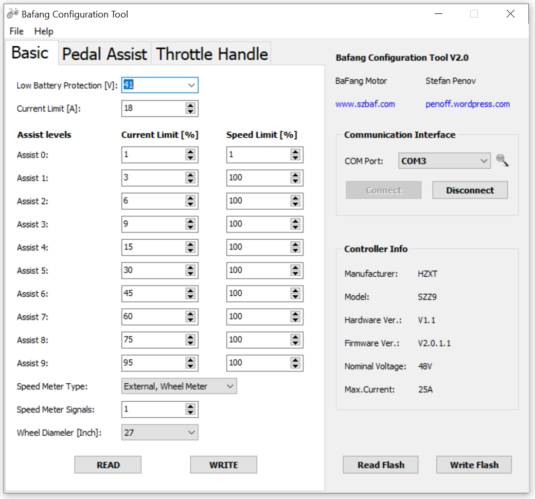

A few drawbacks about the BFANG BBSHD. Throttle can be jerky. Reprograming of the FW will probably be required. What works for me is using the Start Current Sensor to 6 instead of 10 and make sure to set throttle Mode to Current (under throttle settings) One of the con's of the BBSHD is It comes with a crappy chain ring which will need to be replaced, Get a Luna Eclipse or a Lekkie, Another con is it typically does not come with a Shift Sensor make sure you get one. You also need to get a cheap chain guide. Make sure you get one. You really should consider all of these factors when pricing a kit as if you want the best possible experience you should do all of this stuff. Ask me how I know. I will say that the BBSHD is a BEAST. It's been very durable and reliable. It's extremely powerful. To give you an idea. I climbed a hill with a 2018 Specialized elevo in turbo mode and it's far far less powerful from a performance perspective that my BBSHD. Things that will help prevent your chain from popping off: Chain Guide, Narrow Wide chain ring and clutched derailleur. IMO the best bang for your buck here is the chain guide. But you really want all three. The lekkie and Luna chainrings are all Narrow / Wide teeth pattern so your good there and most newer higher end bikes have a clutched rear derailleur like Shimano XT.

The controllers definitely need to be reprogrammed to be more usable on the trail. I went with a config that basically allows 5 lower power levels, and 5 higher power ones. Anything above 30% dramatically reduces the pedaling effort required - to the point I'm pretty much spinning out with a 30x11 on flat.
