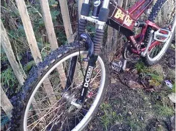

How to install a headset with a brick
I'll show fitting a threadless headset, adapt for threaded as is needed.
The old headset would be fine and plenty strong. I like to overbuild. I got a cup each of two oldschool downhill headsets so that's what I'll be installing. For shits and giggles I'll try to avoid using the proper tools.
Bottom half of a FSA The Pig and top half of a Tioga Alchemy.

Regardless of the methods used I ended up here:
Using anything other than proper tooling on carbon parts is bad taste in my opinion.
