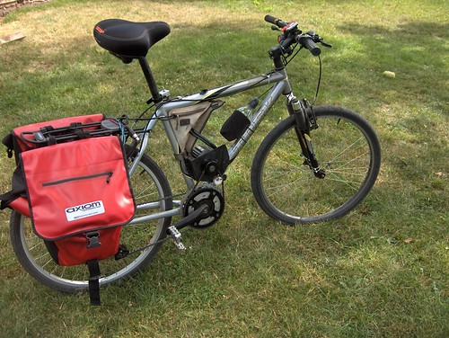

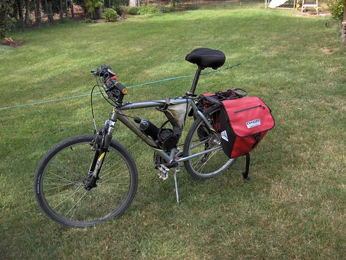

Anyway Here's some info about the Bike rev 1.1 :
1.1:::
Frame: Trek 4300, cheap crappy china made bike (still decent)
Crank Lasco IPS (IPS Standing for Insolent Piece of Shit, way too much play!!!) With machined adapter and 90 tooth gear.
Motor: 24V Kolmorgen with internal controller,
Batteries: 2-12v 20AH SLA's from Batteryspace (or something)
Throttle: Magura 5k
Horn:Airzounds
Brakes : V-brakes
Tires, High pressure road tires, @ 85-100psi
Gear:

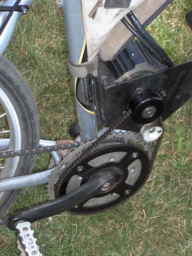

This bike has a lashout gearhead, 4.7-1 (I think) ratio then goes from a 17 toothfreewheeling motor gear to a 90 tooth chainring resulting in a cadence of about 112.
This version has a chain tensioner and a little different motor mount utilizing the water bottle holder bolts. This has a 26, 39 and 52 tooth chainring on the crank. This results in a range of speeds from 9mph to 30.6 (theoretically) more realistically a top speed of ~25mph without wind.
I have been riding this version to work for almost a couple weeks and haven't riden every day but I have riden ~180 miles. I average anywhere from 20mph to ~25 mph depending on wind, and with a tailwind today I averaged ~26 on the way there and about 22 on the way back with the headwind in the afternoon.
I go 8.6 miles each way to work. My max mileage so far in one ride is ~12.6 miles on one charge but I forgot to check the voltage at the end, I imagine it was low; as my top speed had dropped to 19 without wind.
The acceleration is sweet as is the delivery of power and ability to upshift while under power very smoothly!! Downshifting I generally pedal for, as it can be rough, but not too rough for the motor or gearbox.

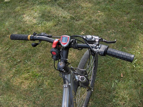

Here are some pictures of E-bike:Version 1.1
The only problem I am having is that the internal 24v controller on the kolmorgen motor seems to overheat after about 8 miles at 23-25mph... it overheats at ~185 degrees f on the controller side of the motor. Then it takes a couple minutes to cool back down and turn back on. I ride about 8.5 miles each way to work everyday so some days I have to pedal other days I make it just fine.
I am really wanting to get an external crystalyte controller for at least 48 volts and run this thing at a higher voltage with an external controller. I think it will really come to life with that!
