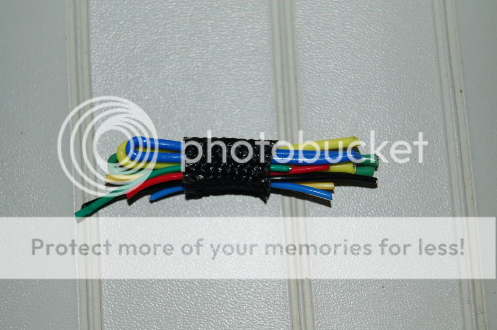

Those big sb50's in red are all my new power lines, the blue,green, and yellow are for my Delta/Wye conversion. Im using the sb50's the pos sides for the original legs, the neg side of each color for the seperated legs. So each color has both ends of that coil, three colors, six leads. But going from the controller to the relays, Im using the 75a power poles.
This is how both my controllers are set up as of now, need to add some sleeving to clean it up, still havent put in a power switch for the Lyens controller, or the usb adapter yet either, tomarrow...usb! I like the mini dry switch methods used, think Ill do that for the power.
heres the inside of my box with the 12FET 45a Infineon, the hall wire block isnt color matched yet, this is a temp set up. The Phase leg connectors are so big you cant even see the red sb50 power connector behind it! LOL The colors on the motor side of the phase is diferent on the blue and yellow cause the motor is golden motor.

Post by SilverSurfer » Mar 03 2010 4:33pm
Hall wire block,

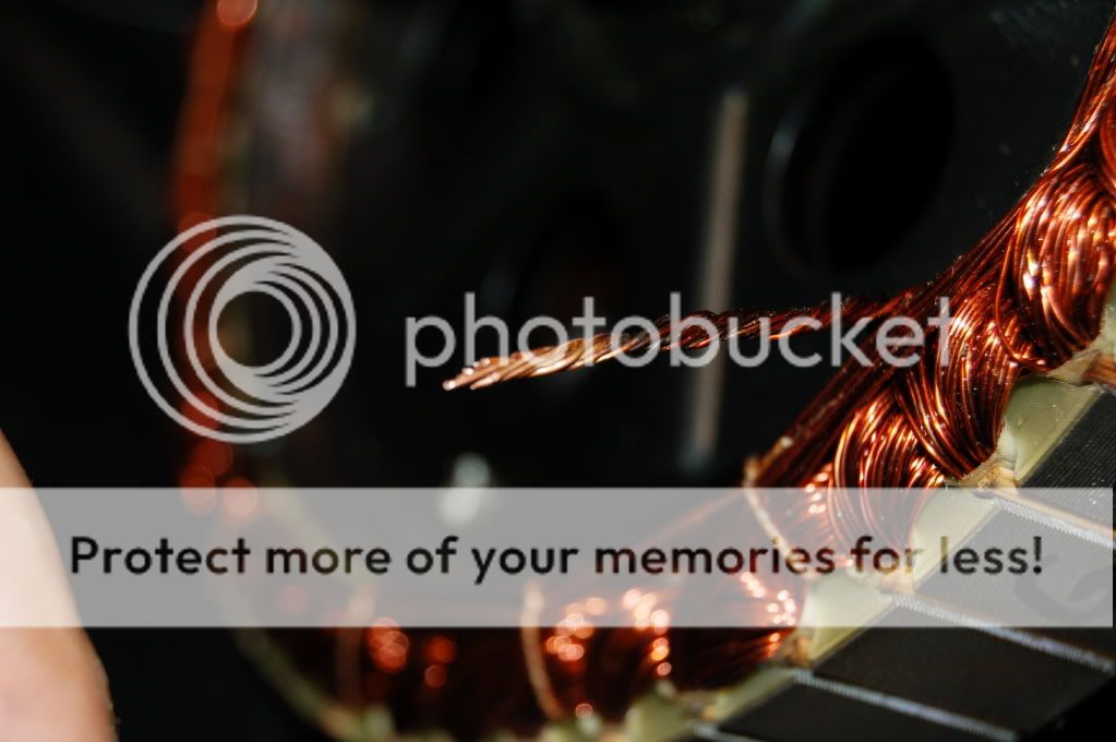

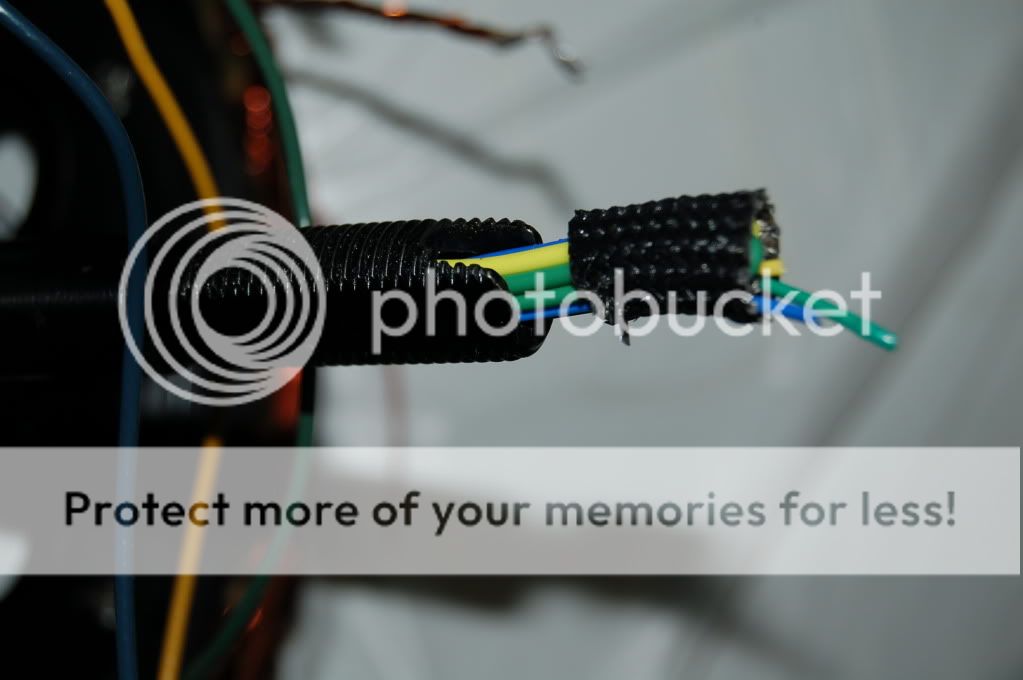

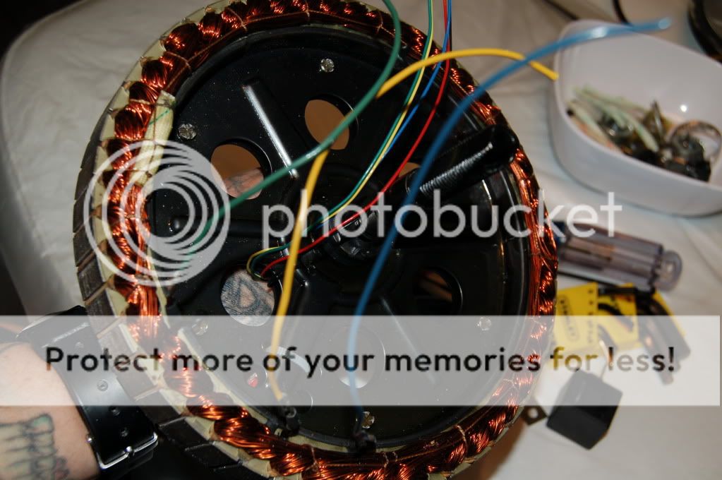

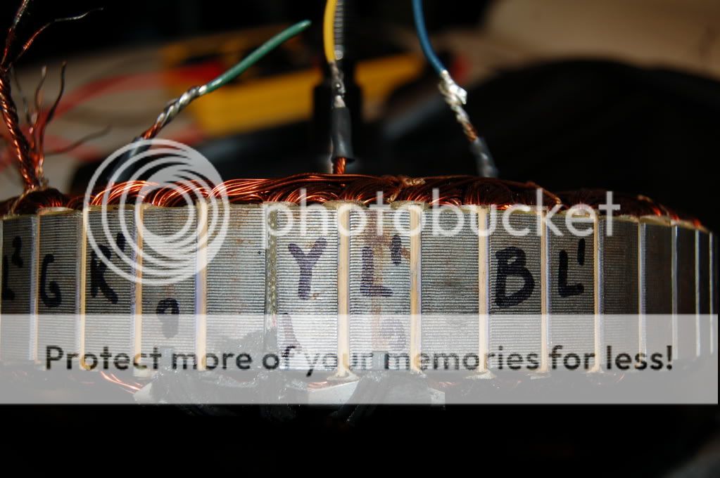

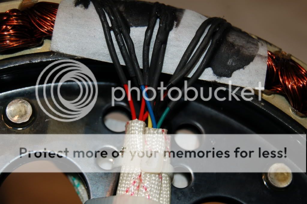

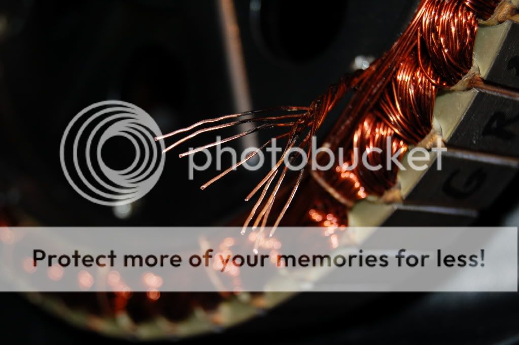

Been working hard to get the delta/wye project going. I got a brand new 9C motor
Not even a mile on it! Time to destroy!
the cover was under much silicone, took alot of work to take off!
used my dremel to grind grooves deep eneough to get a screwdriver under the lip and work around it to loosen the silicone
I like to take pictures of things I might have to reassemble at a later date........never know.
PWNED! LOL
Labeling is good practice too...
I cut off the old crap and started fresh with my own handiwork, I dont trust these companies to do a great job.
Yup, get some flux and solder in that twist!
I was wondering if all these wires would fit in my sleeving.... yup!
But will they fit in the axle...yup on that too!
Sparing you the spaghetti show, heres my version of the hub. Stainless zip ties, Im afraid of the heat melting the plastic ones.
Isnt she pretty now! Just waiting on more parts! More to come......

You shouldn't really be melting stuff. I have essentially the same set up - 72v 60 controller running 10ga power leads and 12ga phase leads with only 45a andersons and they don't get hot. The hub on the other hand you could try and egg on, and that's with air cooling. I'd seriously look into drilling some holes in your side covers or atleast fit a temperature probe.

Actually, when i was melting stuff i was running some very thin extension cord for powerlines. There was a heat build up at the base of the connector, really melted the boots! I switched to 12g Scosche High Performance Speaker Wire, and beefed up EVERYTHING in the power system, then just kept goin. Got carried away maybe. I am looking at the heat issue seriously, but not sure yet where to go with it yet. I live in Fla. and even if it aint pouring, we get periods of misty rain and wet fog that can rival Seattle! Just today, I left it was dry, and before I got to work went through three mist, and a short light drizzle. If ya ride bike in St. Petersburg and dont want to get wet, stay home. LOL evidently its a subject thats been discussed, though I havent found all the threads yet. I read a little of the holes, and filling with some ah..... mineral spirits? I thought about maybe making some custom heat sink that can go between the spoke runners, even entertained the idea of a radiator. Tonight Im bringing my multimeter home with me, it has a temp guage so I can get an accurate feel for where the heat is at. after ten miles hard ride it was hot, but not rediculous. But this is with the 12FET 45amp controller. The 18FET 65amp hasent even been turned on for the first time yet. Still working out all my mods. Anyway, Im nervous about holes were water can do damage instead of heat. Am I just worried about nothing?

No, that stock GM on 72v 45a infineon. Delta/Star not ready quite yet. Probobly a week. Waiting on some goodies, and perfecting my controller.
Hyena wrote:Nice work mate, having just done the star delta conversion myself I know it's a bit of a headache working out all the relay/phase wiring!
I trawled through the 9C star/delta thread a few times then sat there for half an hour scribbling out how I'd wire my relays and with what wires where!
Is that top speed of 39mph in delta mode though ? I get pretty much that exact top speed in star mode on 73v
