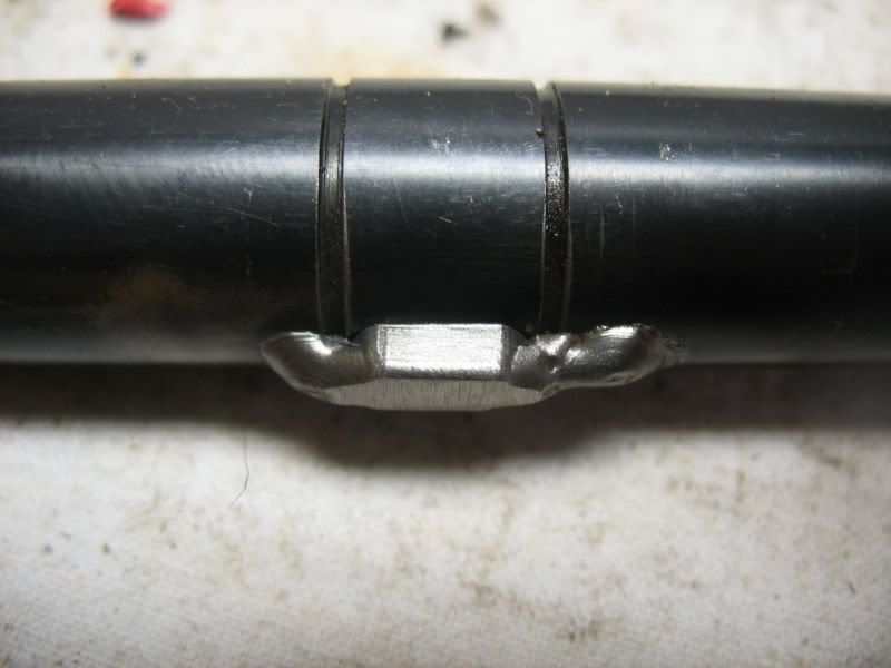

Hyena, I'm not sure about the stock wires, nothing written on them, pretty lite on though.
I decided to do some upgrades on the keys and the sun gear pins after reading Mark_A_W's problems with these two areas.
I had to pull the wires out of the axle and start again unfortunately.
To stop the keys from moving in the keyways I welded them at each end so the components could still slide onto the axle.
I had to grind off some of the weld shown in the photos, so the hub side plates could still side up near the keys.
The other weakness is the sun gear pins, they can work loose as they are only peened over on the end like a rivet. So I welded those too.
I also slotted the other end of the axle like the factory slot on the end.
Here is a photo showing the use of a cable tie to encourage the wires out of the inner hole on the axle.
I have not finished assembly yet. I will post more later.

1000w wrote:
Nice job Matt the welding of the key went very well, after talking to you yesterday
and having a think i agree with you on the JB Weld or Devcon not being the
ideal solution, good weld is also a better choice if doable.
Keep making it stronger Matt, the more you beef it up the less likely anything but the gears
will fail...in a week Matt i seen you ride you cant help yourself DO SKID DO SKID bet you
cant bounce off a kerb onto the road under full power then when you land spin the rear tire goooo on
give it a try MAtt you know you want too hehehe
Seriously best of luck with the rest of the build Matt...catch you during the week for a ride hopefully :-)

While I think that will work.
I do think at some stage you will be grinding it out to fit a new one.
The key is quite soft, it's meant to be. But eventually it will deform.
Damn design needs a proper spline.
Very nice work though. Might send you my spare axle/keys for a bit of electric lovin' ;)

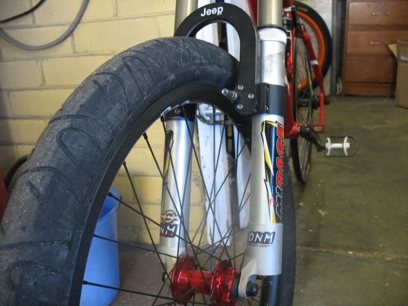

blitzwagen wrote:I've been looking at an old NRS frame that I have and wondering about stick a triple clamp fork on it for a nice offroad electric - I'd love to see pics and get details on your fork to see what the geometry looks like. Cheers.
The bike is a small, 16.5", and the forks are around 700mm from axle to the top. I don't know much about the forks, they are DNM brand with the JEEP name on them.
I got them off ebay, unused off a bike that was pulled down for parts, only $100AU delivered from USA, bargain I think.
I have a 24" wheel and tyre on the front and just a 26" rim on the back. The wood block at the back brings the bike up to where it will sit with a 24" X 2.5" on the rear.
I have not laced up the hub and 24" rim for the rear yet.
Here are some photos.
Hope this helps blitzwagen.
Cheers,
Matt.

Lovin the 24's nearly as much as 20in rims with 3inx20in tires on them.
Are you keping the frame stock colour Matt or will this be taken to the powdercoaters, IIRC it was in pretty good shape when I saw it... I would
still recommend blue powdercoat by "your powdercoat guy" its a nice colour :mrgreen:
KiM
p.s STOP! pinching parts off the cruiser! rip into the Jaffa bike for parts :lol:
I noticed the front wheel don't thinkz i didn't there will be nothing left of the poor cruiser

Chill. :D The cruiser is still mobile, that's a brand new wheel and tyre the same as the one on the cruiser.
Cheers,
Matt.

Yeah those forks were a bargain, I wish I could get a set of triple clamps for that price! Actually this whole build is coming together for a really low price and should be the goods

I really need to get myself some 24" rims for my bike but I need to find a way to get a disk onto the 500W front motor first, that needs to be done regardless, 68kph and rim brakes on the front is not ideal....
That 24" front definitely looks the business on there but it might hurt your max speed a little. Be very interested to see what it produces and it should give you good acceleration.

Excellent looking bike thus far. Those DNM forks looks very interesting indeed - especially the adjustable bridge that could possibly even accommodate a 29" wheel ! Thanks for the pics, the geometry and stance look perfect, it's spurred me into using my NRS frame as a basis for my next build.
