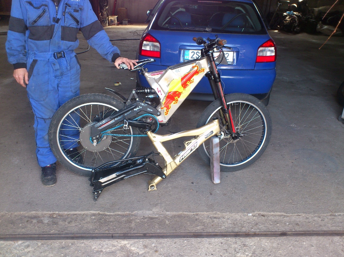

Fastets speed downhill at 70km/h (43mph)
The motor is wide (145cm) so i bought a steel bike, that way i could bend the dropouts.
http://cnebikes.en.alibaba.com/product/ ... _kits.html
The axle on the motor is wide (oblong) so it had to be dropouts on a single speed bike (where you can adjust the chain by moving the wheel back)
Otherwise i could not fit the motor on the dropouts.
This bike also has disc brakes but because of the placement of cable from the motor i could not fit the rear disc breaks.
I fitted shimano hydralic disc breaks at the front wheel, making a big different compared to the mechanical.
A welder made a compartment for the the big battery.
