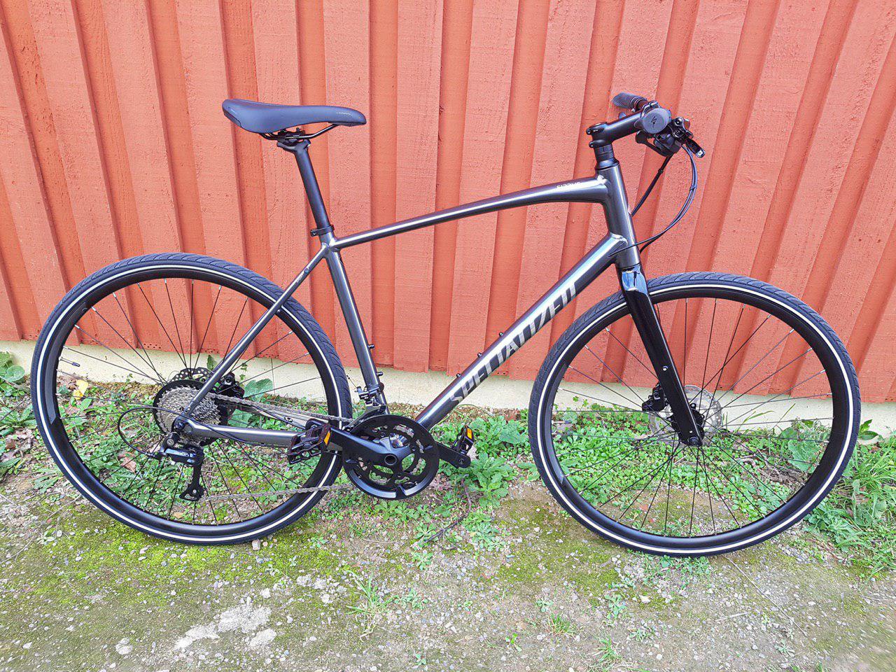

Hello,
Here is my Specialized Sirrus « electro-gravelized ».
BBSHD, 52V (Samsung 30Q), no throttle.
Shimano road shifters, MTB rear derailleur with a 11-46 cassette, 52T front.
11-46 is good for almost everything, from slow speed with 3 kids (one behind me on the bike and two in a trailer!) to fast commuting (around 38mph max).
This machine is extremely efficient and a joy to ride.
Before :
Full size: https://www.casimages.com/i/19022210525 ... 61.jpg.htm
After :
Full size: https://www.casimages.com/i/19022210525 ... 8.jpg.html
