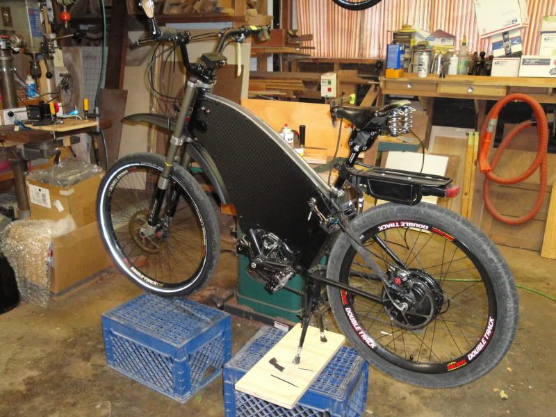

I've got to start this by thanking everyone here. I couldn't have built this without all the help and ideas you fine people have given me. A special thanks goes out to Vim and GGoodrum for turning me on to the Electra Townie. I feel it's about the perfect bike to convert to electric. Even though I've spent a ton of $ replacing almost all the components, It has turned out exactly what I wanted. I think the only original parts are the frame, bars and both derailleurs. Everything else has been swapped out (sometimes twice :mrgreen: )

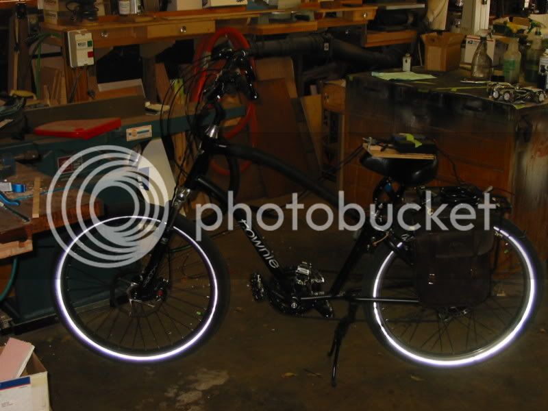

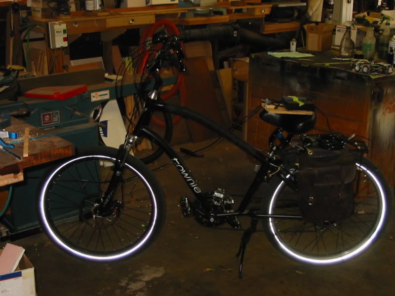

This is how it looked with a 48v/20ah Ping and 6s/2p lipo in saddle bags. It handled OK but I really wanted the batteries in the frame. So far I have added a BMC-s motor with a Clite Analog 72v/35a controller, front disc brakes, 52 tooth front chain ring, Thudbuster seat post, Brooks saddle, CA with amp limit mod and bypass switch on the throttle. It has Big Apple 2.35 tires that I like alot (but would like alot more if they didn't have those reflective side walls). I went over the white wall strip with a magic marker so they don't show up in the day but still shine at night when in the light. I also put on one of Grin's tail lights that are switched when I pull the brake lever.
Lots of wires!

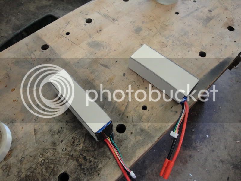

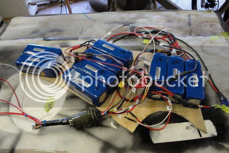

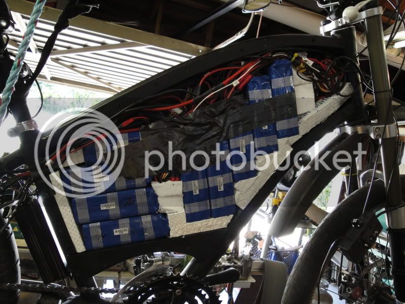

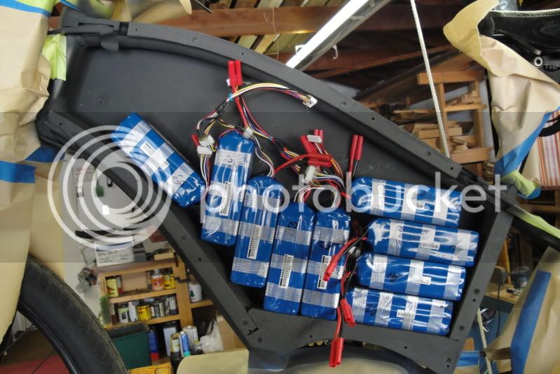

My first attempt at battery placement (18s/3p 5 ah, 25c zippys)

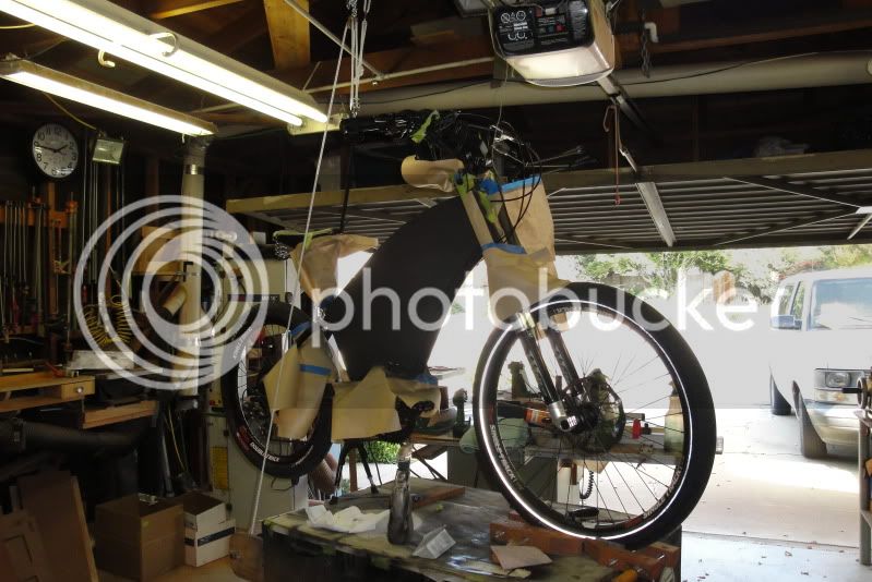

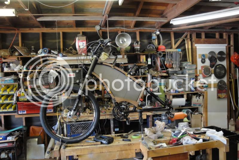

Starting on the enclosure. It ended up being only 2.5" wide. Notice the brand new (but 10 year old) White Bros. DH fork I got off Pinkbike for $185 :mrgreen: .

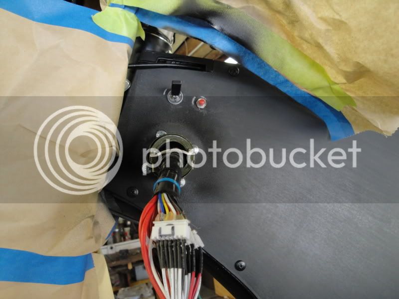

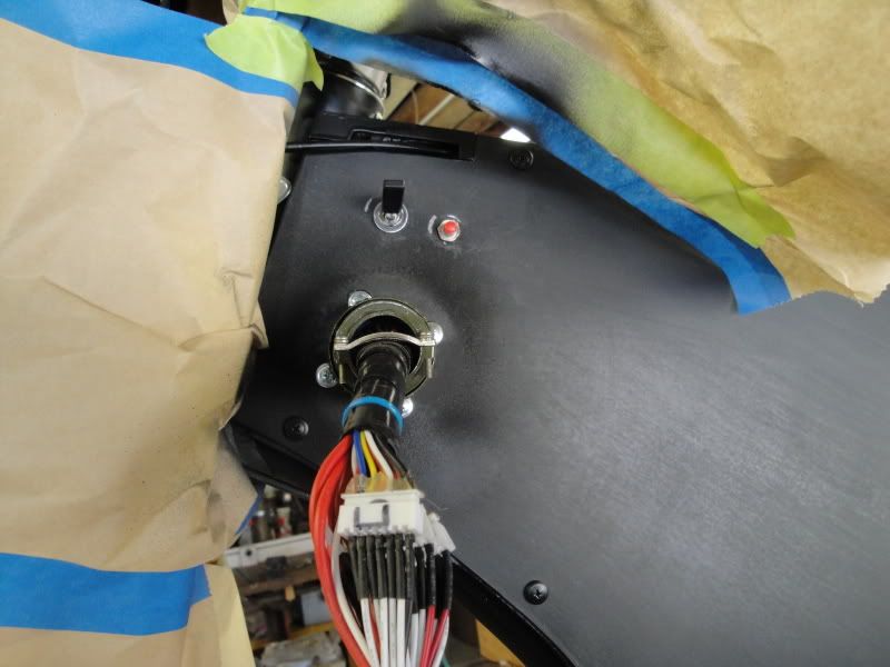

Almost enough room for the controller but I still need to install the key, on/off switch and Pre-charge button. I stuffed the enclosure with styrofoam so the batteries won't rattle around.

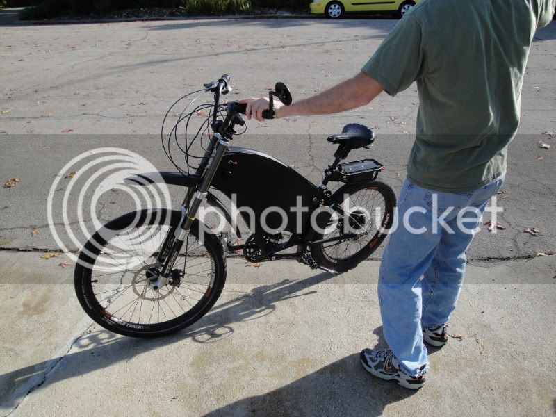

With 2.5 Hook worms on a fat 24" rim and side cover on.

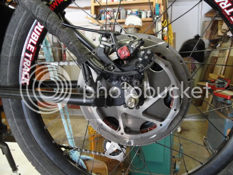

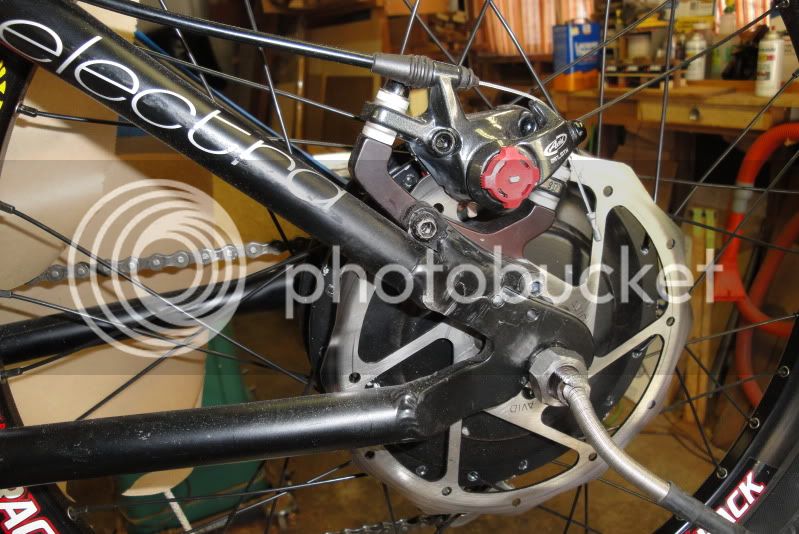

This shows the torque arm (I have one on the other side too) and where I welded on tabs for the 165mm Avid discs.

As to how it performs, If I can keep the motor together, I couldn't be happier. The top speed is about 40 mph (2900w) and with the 24"rear rim, it gets there quick. :twisted: The controller runs cool no matter hard I thrash on it. The motor gets a bit warm in town with lots of starts and stops and the amp limiter bypassed. On the road running a steady 25 mph (900 kw) it stays cool to the touch when the outside temp is 65*f.

The side covers are of aluminum (10 gauge, I think) covered with a $20 carbon fiber sticker. The fender is just a cheap one I found some where on the www. I like them because they come off without using tools.

Let's see a pic of you on it, I wanna see the riding position.
Is that a steel frame?

It has an aluminum frame. The main tubes are almost 1/8" thick. The bike as it is pictured weighs 88 lb.
As to the wheelbase. center to center, front axle to BB 23½", BB to rear drop out, 23½", total wheelbase, 47".
It's the most comfortable bike I've ever pedaled. And to me, it handles like a dream and feels solid at higher speed.

Here is a couple more pics showing battery placement and disc brake tabs/brake light switch.
