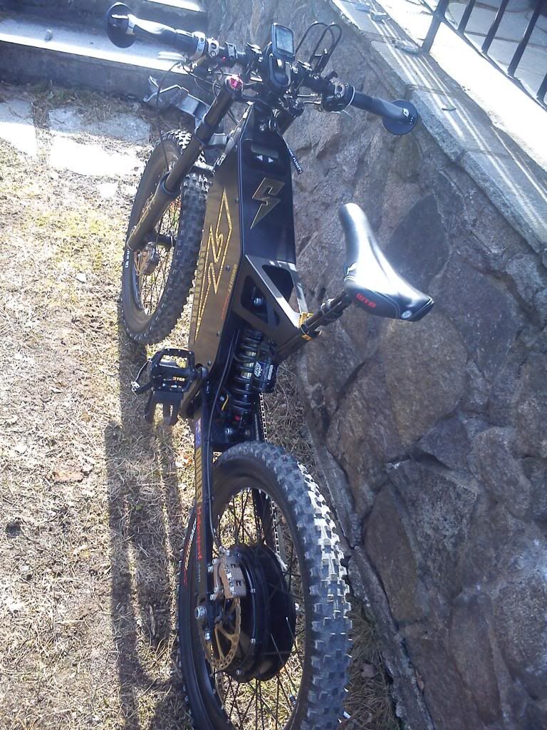

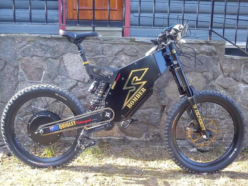

Post by stritzky » Feb 15 2015 10:08am
00Tj wrote:What rotors do you have?
I am thinking about these :
http://m.ebay.com.au/itm/400498156247?nav=SEARCH
Or these :
http://m.ebay.com.au/itm/171117123400?nav=SEARCH
Mostly because I'm going for a black and gold theme and these are one of the only gold rotors I can find.. I really like the look of the second ones. Will these be ok?
I went for the Black and Gold them on my Bomber also and this is the end result.

Post by Theodore Voltaire » Feb 15 2015 10:11am
I really dig the gold S on the top of the frame.

Post by 00Tj » Feb 15 2015 1:11pm
Your bike is the reason I am going for a black with gold trim..
I'm going gold bars, Gold rotors, Gold pegs, Gold seat post calliper thing(like yours) with everything else stock black.
Will pretty much look like yours but without the 2 million dollar side covers :wink:
