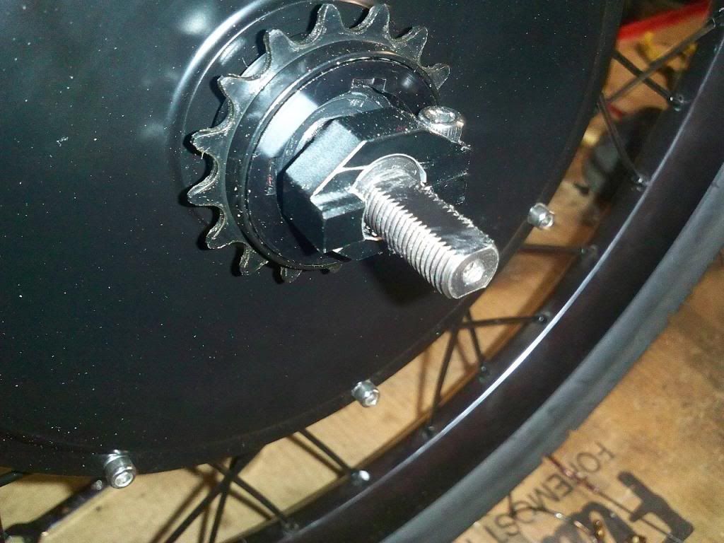

So you rode the bike with stripped axle nuts and flogged out dropouts on rough tracks and used regen? Seriously?
I understand you are pissed off but in all honesty, the weak link is not with the design, but how the bike is maintained. If the dropouts and torque blocks are flogged out after 4 years, then you replace them or repair them.
Stealth bikes are designed to operate without a derailleur and as such need a slotted dropout with a sliding adjustment mechanism to tension the chain. This makes it difficult incorporate a clamping design. However, as long as the clamping block is adjusted correctly and the nuts correctly torqued, nothing will come loose. This has been proven by the fact that the issue of loosening axle nuts under regen is hardy heard of anymore since the introduction of the clamping blocks.

The only reason the axle was stripped was because of the bad design. The only reason the drop-outs were 'flogged' was because of the bad design.
Yeah I probably shouldn't have used Regen knowing the state of the axle, and admitted as much already.
I'm not the only one who has had problems with the dropouts and the small axles.
John what would you suggest is done differently to 'maintain' this part of the bike? I would be interested to see photo's of the condition of any other Fighters drop-outs that has over 10000km over 4 years like mine.
If the drop-out design is so splendid, why does it need the clamping block added?
Are there any other E-Bikes that have this same dropout design? I haven't seen any?

10000 km is a lot of riding. I think in your case your dropouts started to flog out before the the torque blocks were introduced so I imagine it's a bit of an a cumulative situation. It was the regen feature that highlighted the need for torque blocks. Also tolerances on the torque arms were tightened up to cope with the extra load. Just part of the bikes evolution.
In regards to what I would have done in relation to maintenance, I would have simply repaired or replaced the worn parts before they became problematic. I had my swing arm checked and re powder coated just because some of the coating had cracked off in places and I wanted to make sure there were no underlying problems.

I do not have a stealth but on my Giant DH Team with Doc's torque arms the axle of my 4065 was slightly loose so I used a sacrificial feeler gauge set and stuffed the largest size I could to remove the slop. I cut a piece off and put it in there and never got a bit of slop up until my son broke one side of the axle and the other side spun from the cheesy cheap metal the axles were made from.
Just an idea of what you could use to tighten up tolerances if need be.
For the record though, clamping drop outs are the shit!

Cowardlyduck wrote:The only reason the axle was stripped was because of the bad design. The only reason the drop-outs were 'flogged' was because of the bad design.
Cheers
CD, not trying to pick an online argument here, but my Bomber that my dad is currently riding has over 10,000 total miles on that swingarm and about 6000 miles with the current 5404. Not one single problem has me or my dad had with this design. Granted, we don't use the regen braking as we both have also experience axle nuts loosening due to the minute play there is in the torque block and drop spacing during regen braking. But I can also tell you that regen braking has also loosend up clamping dropouts on one of the DIY bikes to the point where the rider stripped out the clamping block trying to tighten that thing down. Point is, a little mechanical sympathy and riding style adjustment is needed for trouble free operation. With exception of Mexican Batman, I haven't seen anyone as heavy as I am riding these machines over the type of crap I ride. I haven't had 1/10th the issues you have. Here is how we solve your axle problems. First, get a new axle. Use a torque wrench and don't exceed 45nm on your axle nuts. Always tighten the disk brake side axle nut first. When you tighten the disk brake side first, you rock the axle in the direction that it wants to move/rotate under power thus eliminating any freeplay between the axle flat, dropout, and torque block when you get on the throttle. And quite using regen. In fact disconnect the button. Just cause its there, it doesn't mean you got to use it. After your first ride, recheck your torque on the axle nuts. They will have loosned slightly so bring them back up to 45nm. Then as long as you don't use regen, they will not come loose and take a set until you remove the wheel. Before you say "I should be allowed to use regen because it came that way" Look at this way, just because my truck redlines at 6000 RPM, it doesn't mean I have to rev it to the limit and drive around in 1st gear when I can shift to 4th gear and do it at 1800 rpm driving around. If I did that, If I left it in 1st, my gas mileage would sink like the Titanic and I would blow the motor eventually. Like I said, not trying to argue with you, but your axle loosening problems can be resolved.

I've had more than 15000km on my fighter, not on the same hub though, but never had any problems with the axel nuts or threads. I check axel nuts/bolts, caliperbolts before every ride.
Torque check is something I do mabe once a month depending how much I ride the bike. Stupid to risk the hubmotor falling off at high speeds.
If it falls off..., it might be the one and only time...

Regen is well documented to be hard on axles and loosen nuts if not properly checked and tensioned and you set out knowing yours was damaged and used it anyway. If it ripped off the bike like that it was either so badly damaged you shouldn't have even considered taking it out and/or you would have felt it clunking and rocking around prior to that. I've had nuts come loose mid-ride and when you feel that first clunk of the axle shifting that's your signal to not use regen again until you get home and tighten the nuts up.
Also as remf said your bike is far from standard so it's additionally unreasonable to blame stealth for the failures. You're using a much more powerful controller and battery pushing almost double the power the bike was originally designed to take. Not that I can preach, I was one of the first people around with a hacked fighter (same vintage as yours) and running even more power again but I always knew that if anything failed it was totally on me. Incidentally, nothing ever did fail even when I had it set up running 9000w and heavy motorcycle rims and tyres with speeds topping out at 100km/hr. I had a heap of broken spokes that gave in to the torque of the brutal acceleration and regen, buckled rims from plowing through rough terrain too hard and multiple crashes - but never any issues with the dropouts. More recently Alex had his old bomber up to 12kw safely on the stock frame and there are others around on this thread (who's names escape me at the moment) running higher power without failure too. Not that stealth encourage or support this.
So yeah, I think blaming stealth is a bit rich...

Well, it seems I've hit a nerve or something with my previous comments. I was pretty pissed off at the whole situation yesterday so may have pointed the blame finger too harshly in Stealth's direction. I apologise if it seemed like I was twisting the truth at all.
It is still my opinion however that the design leaves a lot to be desired. I do also recognise that my situation is far from perfect and I have made a few mistakes myself along the way. Mainly that's over-tightening the axle nuts...it was the quick and 'easy' solution to the rotation issue...but clearly a mistake.
Kepler wrote:I think in your case your dropouts started to flog out before the the torque blocks were introduced so I imagine it's a bit of an a cumulative situation. It was the regen feature that highlighted the need for torque blocks. Also tolerances on the torque arms were tightened up to cope with the extra load. Just part of the bikes evolution.
Yes, my drop-outs were flogged out before the axle clamping blocks were added. The thing is before that point in time (2012-2013), that 'flogging' occurred because the bike was used as supplied by Stealth in stock form. My Fighter (#66) was supplied with Regen from the outset...one of the first. I vaguely recall being told by Stealth (John K) that Regen was a feature they had been testing for some time prior to that point and only decided to introduce it after they were confident they would not see any issues with axle rotation. I lost count of the number of people reporting axle rotation issues on this thread because of Regen.
Yes the addition of the axle clamps helped, but in my case (and others I recall) it did not eliminate the problem. When I first reported my issues to Stealth (back in 2012) I was sent the newer (at the time) 'tighter tolerance' torque blocks. Again...didn't eliminate the problem for me. Then after complaining about it E-S member sent me some custom made aluminium axle clamps. That also helped, and even stopped it for a time, but not for ever...then Stealth started supplying axle clamps as well, so I got one of them...again seemed to help, but didn't eliminate the problem.

Slipping something into the gap is one of the few things I haven't tried yet. How did you manage to squeeze it in there? I can't see how I could get anything in there...I can't even see a gap!

Rix, I think your situation doesn't really apply to me as for one your high mileage is on your Bomber...which is a Bomber...not a Fighter, so the axle diameter is different. I believe the small axle on the HS40xx motors is one of the key contributing factors into all these issues. There just isn't enough meat on the things for the design used on the Fighters drop-outs if Regen is going to be used IMO. A correct design would factor in the small axle of the HS40xx motors or use a different axle.
Also, you say you don't use Regen on either bike...I think if I hadn't used Regen I wouldn't have half the issues I'm now seeing, but that's not the point...these bikes were marketed, and sold with Regen...the design should also allow it. For me Regen is essential, both for the extra range it gives and the great braking effect...I will do everything I can to keep it as an option.

Right now, and yesterday when this accident occurred, the bike was essentially a stock set-up. Stock 16S LifeP04 pack, 18Fet Infineon (limited to 50A), HS4080. The only exception was the forced air cooling fan mod to the motor which bares no relevance to this issue.
Yes, I've (briefly) run higher power (5KW) previously, but I nearly smoked my HS4065 doing it, so it didn't last long. The dropout/axle issues occurred way before any of that anyway.

LOL :lol: My apologies for never following up on that...it didn't work. The forces at play are way too much for heat shrink to do anything. It just crushed/cut and didn't do anything really. As you can see though...I've been trying different things to address this issue for a while, but so far nothing has worked.
I've now tried so many things to address this issue I've lost count...that's why I'm saying I think it's the design. I'm happy for that to just be my opinion if that's all it is...but it's mine to share and up to others if they want to listen or not.

I just wiggle the axle and stuff the most in that I could. My axle never came loose nor did my axle nut. I did and always do use blue loc tite just to be on the safe side.
Might help in your case and definitely couldn't hurt.

I used to think you couldn't use regen without causing the axle to loosen, even with the torque clamp. I was following Rix's axle tightening sequence, but it was still coming loose.
I discovered what I was doing wrong was using a small allen wrench to tighten the bolt on the torque clamp. You can't get enough torque on the clamp bolt by hand with a little 6 inch allen wrench. You need at least 15 ft lbs on the bolt, but most people won't be able to get more than about 12 ft lbs by hand. The solution is to use a torque wrench, because 15ft lb is close to the maximum amount you can put on the clamp without stripping it out.

Jay, I am trying to keep it tight now... and failing. Don't you realize there are people wearing suits and sitting in offices and not trying to spit their coffee out their nose? For me, its beer, and failing miserably. :lol: :lol: :lol:
Axle mod.jpg (99.13 KiB) Viewed 2998 times
