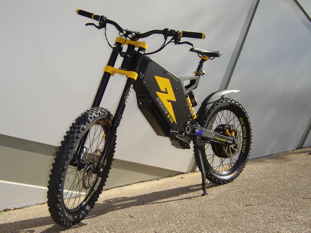

URGENT URGENT URGENT DEMO BIKE JUST STOLEN#
Bomber/B52 #658 stolen from Glandore oval Edwardstown around 5pm today. False ID given and name given was Mark and female accomplice driving Red Honda Civic. Mark was unshaven, wearing black arai full face motorcross helmet, wearing dirty high vis top, blue jeans and sneakers. If anyone hears or spots this bike please call Lincoln on 0406 347514. Cheers

Lincoln that sucks big time :twisted:

Post by Rodney64 » Aug 12 2015 7:04am
Sorry to hear Lincoln, hope you get your bike back.

Post by White Knight » Aug 12 2015 7:48am
I will keep a look out Lincoln, can't believe those scum. :evil:

Post by Samd » Aug 12 2015 8:43am
bloody hell. stolen.
will be looking out for that. mark my word.

I need to ask this again because I'm still not clear on the answer. With the new DNM forks on B52s, is it correct that the lower legs don't line up the axle holes. This doesn't seem like a good idea to me. What nincompoop thought up that design?

Theodore Voltaire wrote:I need to ask this again because I'm still not clear on the answer. With the new DNM forks on B52s, is it correct that the lower legs don't line up the axle holes. This doesn't seem like a good idea to me. What nincompoop thought up that design?
Its because they are a separate function fork. My current fork on my FIghter (Groove 180) is the same way.

Post by Theodore Voltaire » Aug 13 2015 12:21pm
Is seems like this would load the wheel bearing a little.
Another question is about the tightening procedure for the axle. Since the axle doesn't thread into the fork leg, what does the bolt on the right side of the axle do? Does it just act kind of like a cosmetic cover for the end of the axle?

TV,
the top of the fork legs need to be even on both sides..
the front axle end nuts are a second security for not losing your front wheel..
http://www.dnmshock.com/upload_files/fork-manual.pdf
