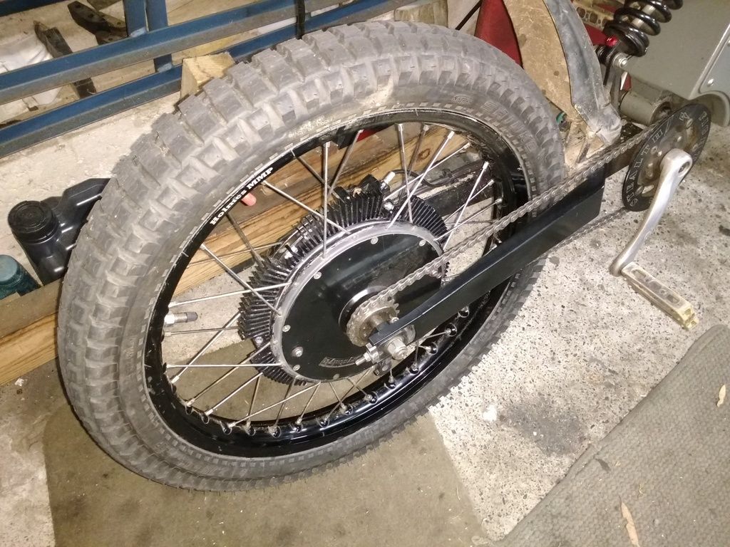

Before and after photos.
Before: Fighter controller, 19x1.6 rim, VRM-021 tyre, H4040 motor (yes it really is), stock 59V battery, 100ml castor oil in the hub, Tubliss system. My custom shock and forks. Very good, but it got a lot better ...
After: Bomber controller (no DC-1 restriction), SR241 tyre, Tubliss, short 140mm cranks, sealed CrMo freewheel sprocket, 18S2P LiPo batteries (75V charged, 150% range and lighter weight (thanks CD)). Hubsink. Axle clamp glued to the axle. All hub wires routed on the top of the swingarm. Fine strand flexible and durable 14 AWG phase wires with thick silicone insulation.
This latest rear wheel and tyre setup is so much better. Superior grip. It grabs the ground and it quite gentle to trails. Way better rim protection from direct and side impacts. Running 15 PSI now and less rim hits than with 18PSI and the older smaller tyre. It weighs a bit more. Forget how much. But the ride quality and performance is way better. Love it.

Hell of a write up Emmett. Glad you are happy with your mods. That 4040 with the 18S will scoot right along up to about 30-33MPH I imagine. When are you going to get into making some vids?Emmett wrote:Before and after photos.
Before: Fighter controller, VRM-021 tyre, H4040 motor (yes it really is), stock 59V battery, 100ml caster oil in the hub, Tubliss system. My custom shock and forks. Very good, but it got a lot better ...
After: Bomber controller (no DC-1 restriction), SR241 tyre, Tubliss, short 140mm cranks, sealed CrMo freewheel sprocket, 18S2P LiPo batteries (75V charged, 150% range and lighter (thanks CD)). Hubsink. Axle clamp glued to the axle. All hub wires routed on the top of the swingarm. Fine strand flexible and durable 14 AWG phase wires with thick silicone insulation.

+1 from me. Good work. Sounds like we ought to line up a ride and I'll bring some cameras..I've hit similar heat here on Central Coast, but the great thing about the eBike is that your exertion level is lower than normal pedalling, if you're prepared to use the throttle on a hot today for the sake of a little personal comfort.Rix wrote:Hell of a write up Emmett. Glad you are happy with your mods. That 4040 with the 18S will scoot right along up to about 30-33MPH I imagine. When are you going to get into making some vids?Emmett wrote:Before and after photos.

Awesome stuff Emmett. Glad your liking those batteries. I am too...managed to hit 88kph on my HS4080 now....insanely fast!
I would suggest upgrading those 14awg wires outside the axle. Through the axle, yeah you need to size down, but for the run from the axle to the controller, the bigger the better for those wires. Fat wires for that section performs a dual function of reducing electrical resistance and also more importantly it helps wick away the heat build up from inside the motor.
IMO 14awg is undersized for our motors anyway. It's a bit tricky to size wire for our 3 phase PWM motors as the flow is not continuous and we roll on/off the throttle, but as a rough guide read this:
http://rookiercflyer.com/understanding- ... ent-rating
For all my motors I now use 8awg from just outside the axle, and 14awg through the axle.
Cheers

Then I built a base from wood to hold the wheel in place with a wrench on the bottom to keep the axle from spinning
- Attachments
- Base
- IMG_0144.JPG (36.22 KiB) Viewed 2898 times
Re: E-S Stealth Electric Bike Owners
Then the task of cutting new threads was undertaken on both ends of the axle. I figured I may as well do both. It turned out great and I am bale to torque down on the axle nuts again.
It took a day of welding and a day of cutting. I went really slow and proceeded with caution during the cutting phase using Harbour Freight Titanium Nitride tap and die set.
In the end this fix didn't really cost me anything other than my time. Axles with huge amounts of copper around them make great heat sinks for welding
- Attachments
- IMG_0139.JPG (31.85 KiB) Viewed 2904 times
- IMG_0145.JPG (39.41 KiB) Viewed 2904 times

Great stuff st35326!
The other way to tackle this is to downsize the threads. I did that on my 1/2" HS4080 axle taking it down to M12 and so far it's been fine.
The other part to this is to get some of my replacement torque blocks to prevent it happening again.
viewtopic.php?f=31&t=86054#p1258704
