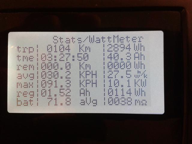

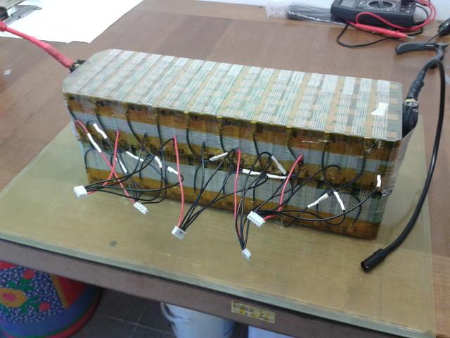

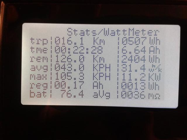

My new battery is ready and the first data I have is amazing :mrgreen: 105Km/h top speed and 104Km range :mrgreen:
Also I have 92% of nominal values at 40,3Ah 2894Wh :shock:

Good god! Who made your battery?

I built it myself

Great Job!
and Alex is a very good teacher !
Are you happy with VTC6 cells ? How much your battery pack sags when you are at the boost mode?
I am considering VTC5A cells for my next battery pack, I've read they have the smallest internal
resistance available for this capacity and they are voted as the best cells for 2018 for this combo power / capacity.
https://www.18650batterystore.com/Best- ... -s/142.htm

Yes I'm super happy with VTC6 cells; now I have an e-bike that can outlast me :D
All depends on the peak and continuous current you want to pull from the single cells.
In my case I have 11.5A peak and 10.5A continuous so with these numbers I stay around 79V full throttle with the battery hot of charge.

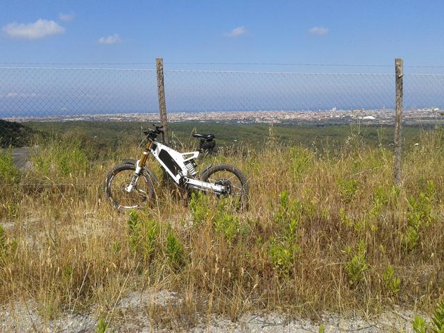

This is a picture from the trip I made yesterday. In the background there is Livorno city and the sea.

That means they are great cells! My 20S-9P battery pack when is charged at 82V (4.15V per cell)
it sags at about 72-74V with load 12,8A per cell.
Next time I will try Sony cells the only think I worry about is that Sony will sell the battery department to Murata
and We don't know if Murata will do the same good job.
