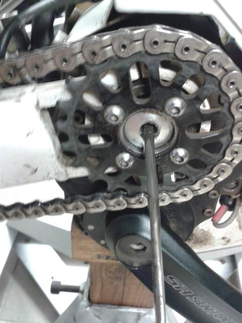

I have a question for anyone that has stripped successfully a b52. I have a 2015 b52 that i want the frame to be repainted due to damage. I m in the process of taking it apart so i would like to ask in order to avoid any damage. Below are my questions for which i would appreciate your replies:
a. How to i safely(without damaging) remove the cycle analyst from the frame (please check the photo)
b. How to i remove the spring from dmm rear shock (the spring only)
c. Is removing the front fork(888) straight forward as it looks or is there any trick i should be careful of.
d. Do i remove the the gear shifting cables , from the hand shifter to pass them through the frame? or do i remove them from the gearbox?. Is there something i should be careful of ?
Many thanks

a.probably same as CA attachment method?...bloody strong double sided tape...be carefull!!
b. undo spring preload collet...compress spring using spring compressor or very strong friend...slide off slotted collet.
c. same as a bicycle...undo headtube retaining screw...loosen and remove stem...loosen and remove top triple clamp...slide fork out bottom being careful not to lose ball bearings/races..use soft dolly to hammer out bearing cups pressed into frame...I recall mine were a tight fit and took some caution but firm hitting.
d. shift cables on a drum assembly that screws [three screws] to the side of the gearbox [either first or ninth gear when removing?]...avoid removing cables from the shift drum and I also don't suggest you pull apart the gearbox beyond removing the shift drum...very easy to make a mistake and messy to get right again particularly if one is not mechanically minded/skilled!

Only tricky part as you mentioned was to remove the CA .With a little assistance of a blow dryer it came off. But double sided sticker was destroyed completely. Not much harm caused though. I guess they are supposed to be one use.
Regarding the gear shift, yes i removed the shift drum from the vbox and passed it through the hole of the frame, that was designed just enough to pass through.
After i stripped the bike to its bare frame, i think stealth did a very good job on this and maybe that explains why it still is (several years already) one of the best bikes in this category. The frame is just right, with no extra weight/excess material used/with all screws easily accessible/safety in mind/ i think even if a 1 or 2 frame screws would fail simultaneously , the bike wouldn't break apart .

I have a question regarding the V-boxx: did you get replacements gaskets or other parts to rebuild the V-boxx?
1abv   1 kW
Posts: 475
Joined: Mar 29 2013 11:19pm
Re: E-S Stealth Electric Bike Owners
Post by 1abv » May 08 2018 1:10pm
I have never had to deal w getting new gaskets etc. they are made out of a rubber material that is made to be re-used. and even if it broke I would just chuck some silicone or yamahbond in there and call it a day.
As far as getting internal parts for the vboxx its not easy.. Your best bet is to get them from stealth or find someone w spares. Even then its a pain in the ass...Thankfully the internals of that thing are pretty strong. Interesting note, some of the internal parts are hand stamped with construction dates and initials on them...
If you follow D-logic youtube vid its pretty easy. I did a few mods to what he said, for example I made cardboard "templates" of the side cases, drew w marker all of the locations of the bolts and pushed the actual bolts through the cardboard so I would never loose them or put the wrong bolts in the wrong place.
The most challenging part is the reassembly and making sure the detents on the "clutches" line up with the bearings on the aluminum d shaped rods and the other part is aligning the square ended shifter rod with the shift cable assembly. The clutches have very fine teeth on them as does the shifter rod and can be moved out of place easily.
why are you taking yours apart?

I lost 1st, 2nd and 4th gears. I mean when I select these gears nothing happen and the pedals spins forward freely, I guess the clutches do not engages for some reason. I also have a grease leak from the center of the chain spur gear that I fixed with a rubber stopper.

bigbore wrote:
May 08 2018 1:48pm
Martin, aka Dlogic made these repair vids for the Vboxx. They are awesome. You should be able to figure out why 1, 2, and 4 aren't working.
https://www.youtube.com/watch?v=Zgog-W3QLVw
https://www.youtube.com/watch?v=1oI2O1F0k3g
https://www.youtube.com/watch?v=pruRTLlFsiA

bigbore wrote:
May 08 2018 1:48pm
Bigbore check this diagram out...
you may have an issue with center gear on the shaft that your having the leaking issue with. (look at the diagram. the shaft on the top of the diagram) How did the issue happen with the gears spinning? did you hit something? or happen at once? or was it gradual? The leaking has 3 possible spots that I can think of. The gasket under the large chromed bolt in your picture or either of the side cases/bearings where the shaft rests. The shaft is hollow and runs the width of the vboxx.
Thank you for the advice, the issue with the gears happened gradually. It started with 4th gear first than also 1st and 2nd gone bad. Looking at Dlogic's video I guess the clutches do not engages.

Yea if it was a sudden thing It could have been a gear but hopefully its just a misalignment issue of the teeth on the clutches which is not that hard to fix.
