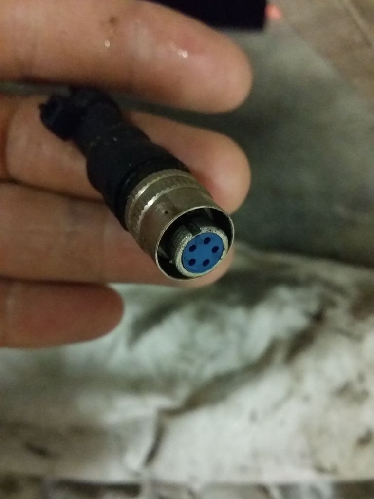

Re: Fighter round plug type to motor
Post by Emmett » Oct 01 2015 4:10am
Hi Guys.
What is the name of this plug type?
Is is possible to repair a broken connection inside? Or is it permanently crimped?
I've obviously not tried yet.
I have a fault in there.
Caught the loom on a stick or something on the trail. Had to happen one day I suppose.
Phase wires can self unplug, but this baby has the clip lock is it got pulled real hard. Seems wobbly and broken.
I was just thinking about re-routing them above the BB. Damn it.
Thanks in advance.

They are known as Mini XLR 5Pin.
Here's one for you:
http://www.ebay.com.au/itm/5-Pin-Mini-X ... 1042208696
It's a good thing they are cheap. :)
Oh and they are a B*tch to solder!

Cowardlyduck wrote: They are known as Mini XLR 5Pin.
Awesome. Thanks CD.
I'll go to Jaycar tomorrow and try buy a pair. Not looking good in their catalog though. :cry:
I'm pretty sure the female one (in my pic) is the one with damaged wiring behind it.
Hopefully I can work out the colour to pin combos.
Two questions:
If I guess the pin to pins wrong, and do a test (give it a little throttle), will I damage something?
Can you recommend a better plug type for the temp sensor wires?

What, these are microphone plugs? That's handy to know.
I would recommend finding someone who is very skilled with a soldering iron because not only do you want rock solid reliable joins, but if there is any solder contact between pins you can kill hall sensors in the motor, I did and it was a world of pain. It's very did fly and no second chances if you get it wrong.
For added protection I also potted my connectors with quick setting araldite after soldering, but there is potting glue available apparently.
This really is the Achilles heal of the fighter wiring and if you can re-route it please share pics, I'm even more dubious now I hear it is a microphone Jack, have to go easy on the creek crossings.
Last rear puncture I left the wheel on the bike and pulled the tube out to fix it, I just did not want to mess with the nicely sealed up connector, it's a sure bet that's where gremlins get in!

SUNDRIVE wrote: if there is any solder contact between pins you can kill hall sensors in the motor, I did and it was a world of pain. It's very did fly and no second chances if you get it wrong.
Now that's handy to know too. I've got a bad feeling I could have shorted something when trying to make it work to get home.
Perhaps my bike will be out of action for a while, just when I have some ride time available. Argh!

Here is my old connector on the left, just use a small iron tip and you will be fine
Now I would not recommend resuing them as they are not waterproof, just google for "waterproof connectors" and you will get a tons of alternatives
Like this one:
http://www.ebay.com.au/itm/5x-WATERPROO ... 0699429804
