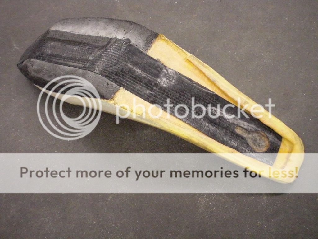

Custom seat made from modified MX bike seat.

Very nicely done! I love everything on the design except the front fender. I'm guessing you guys are from Cal Poly Fullerton? What are your impressions of it so far compared to other MX bikes?

I was impressed with how close the actual frame dimensions were to the drawing. How about a shot of the battery compartment door? Was the internal foam removed by some process of left in place?

Right now the batteries enter from under the seat, one of the things on my list is to make them quickly removable. The motor controller is mounted on top of a bracket that holds them and their insulation in place. I will probably also mount the charger in there. The foam was removed with a speedbore, then a putty knife. Once the core was turned to shreds with the speedbore the rest chunked off the sides pretty easily. There is no foam left in place, it was high density foam, which was pretty heavy. The male mold method was quick and dirty, a female mold would produce the nice outer finish but for this project would have complicated the integration of the subcomponents.

Could you post more info on the sub-components? Specifically, their design and connection to the frame proper? After the analysis do you have any concerns with any of the metal/composite joints? That seems to be the most common cause for concern with hybrid material frames like these
That was a concern, but the methods we came up with makes the metal parts one with the carbon fiber, I am pretty sure it would break around it before the inserts came loose. The parts are physically locked into the carbon fiber by their geometry, and do not rely on the incidental chemical bond.

dpearce wrote:x88x:
Is that from the knurling and the large lip? Good to know. I don't really have any experience with CF atm but it's one route I'm considering for a custom frame build if I can convince myself that there won't be any issues with stuff like that.
