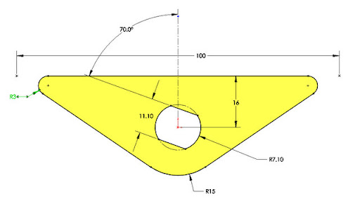

There is a thread on it here. http://lh3.ggpht.com/_xtfwwaIXUcM/SrmQ6 ... CT0376.jpg
Basically the axel is 90deg to the flats, so the 14mm axel fills up the space. Then I use custom torque plates to transfer the load to the frame.
The picture show the first ones I made, but then I changed to longer arms, worked perfect.
The distance between flats should be 10.1 not 11 as shown in the drawing. Once zinc plated they are a snug fit.
Showing original reaction plate.
Showing new plate design (note should be 10.1 not 11.1 across flats.)
Sorry dont have picture of new plates they have gone with the bikes.
I can supply a DXF file for you to take to a laser cutter or CNC mill person, or can make and send you some reaction plates in the post.
I made custom ones for the front too. I will find some pics of them.
