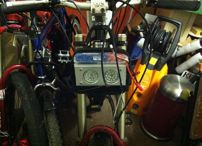

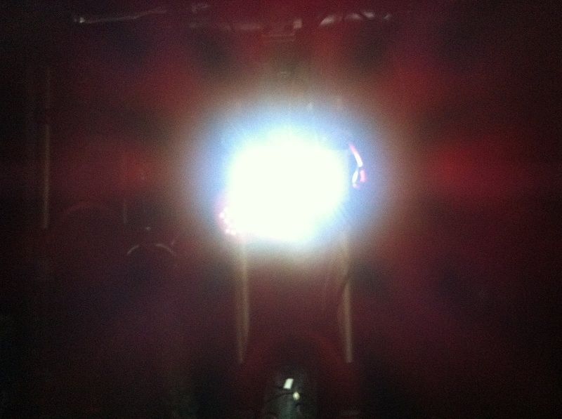

Just want to post about some recent successes
new diy lights made from energy saving led lights and powered by a 3s stick of zippy lipo.
on
off
