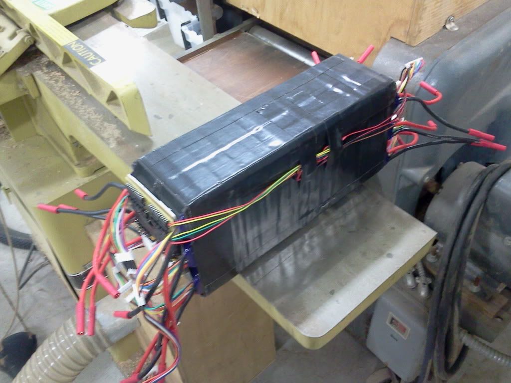

That 5400 is a TANK for that amount of power you get out of it. I guess the Sevcon is no lightweight though, and bolted to a heatsink that is also pretty fat.
When I weighed my pack it included the fechter BMS, all the wiring and two sheets of aluminum, plus an entire roll of gorilla tape.
Test Review Revise Repeat

Farfle wrote:That 5400 is a TANK for that amount of power you get out of it.
Yep, everything on this bike is seriously overbuilt for the mere 8kw I am putting INTO it during the current "Phase I" - but as posted earlier, it is built up like a TANK for "Phase II", where I swap controller/batteries and feed it 30kw in my quest to exceed 100mph. Looks like KV would limit this winding to 86mph on 144v though, right around the 81mph you are seeing. It is funny to think that a heavy-duty Outrunner build and a heavy-duty Hubbie build could end up being so similar in terms of weight, power, and top end. :D
Ah, that explains it - with LiFe I don't need weight of the BMS or complex paralleling/charging wiring harnesses, and your figure included the aluminum sheets/gorilla tape that would make my Pelican-cased weight a more fair comparison. How do you secure the pack to the frame? At any rate, that means I can still count on a saving a few pounds by going to a 144v lipo pack with the same WH, to offset the heavier 144v/400a controller (200a battery side).

Am I correct in thinking the bomber is a 5405 winding in a 26"-27", I wonder how the "gearing" compares to a taller 5403 in a smaller 23.5" OD wheel. Great tip on the 120% throttle to get 50mph, I'll try that - I knew people had done that on the infineons, but I thought it was to get more amps into the motor, I didn't think it would add to my top end! :D
-JD
Standard Bomber uses 5403 motor and has 24" wheels. Pack is 24S Li-ion bagged cells 18AH with BMS. 65A limit set in the controller. :D

Kepler wrote:Standard Bomber uses 5403 motor and has 24" wheels. Pack is 24S Li-ion bagged cells 18AH with BMS. 65A limit set in the controller. :D
Thanks for setting me straight, looks like I had a lot of misconceptions there. :oops: I had no idea my motor's gearing ended up so close to the Bomber's, gotta figure stealth knows what they are doing. Maybe I should try going from 100a to 65a and see how that affects drivability at 120% throttle!
After my last ride on the bike, I heard chafing, and realized that it was the plastic insert that goes between the phase wires and the axle (see picture), even though I specifically oiled it before re-installing it. I noticed that the insert was rotating, so the edge of the cutout I dremeled into it was pressing up against the phase wires, probably flopping back and forth with regen, so it could eventually pinch-cut the wire insulation and allow a short. I thought pressure from the dropouts would hold it in place, but I guess not. Thinking about drilling a hole in the removable dropout, inserting a piece of metal as a 'key', and drilling a matching hole in the plastic insert. I figure I should keep off the bike until I get that sorted :roll: but I might not have time until next weekend or the one after. :|
