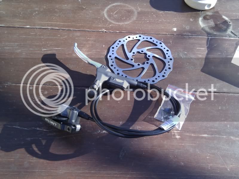

Brakes: Hydraulic front and rear Tektro Auriga Comp
The project is gona go slow, i need to build my workshop in spring so i am trying to assemble as many loose ends as possible.

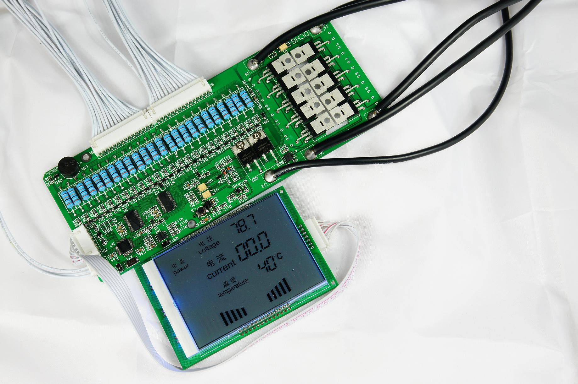

I am trying to get the cell clamping plate designed, here is the arrangement the cells will be in:
I want to keep all the components inside platform base, probably 70mm deep.
Here is the plate i am trying to work on, no EagleCad experience here, no time to get in to that stuff, using what i know:
There will be tracks added to solder in BMS wires so i dont get loose conections. A guy quoted me at 28USD a piece, designed and made, i need two to go in front of each other.

It is the coolest looking BMS I have ever seen. Can you give more info about? Nice part choice and cargo bike with optional seats is even better.
agniusm
Posts: 2355
Joined: Apr 16, 2011 3:06 pm
Location: Lithuania, Zarasai
Re: Custom frame cargo bike thread
Post by agniusm » Jan 03, 2012 7:52 pm
parabellum wrote:It is the coolest looking BMS I have ever seen. Can you give more info about? Nice part choice and cargo bike with optional seats is even better.
Here is the spec. sheet for 100A output one:https://docs.google.com/open?id=0B56NVZ ... kzMzliZTlm
, you can find the link at the bottom of the document. 260USD a piece with LCD + shipping (TAX if applicable)

agniusm wrote:Here is the spec. sheet for 100A output one:https://docs.google.com/open?id=0B56NVZ ... kzMzliZTlm
Thanks, do you have played with it already. Do you know adjustment limitations for voltage in software? (asking because, they say it is for LiFePO, but if voltage is adjustable to 3V on LVC, to 4.2V at HVC and at least 4.1V for balance limit, it will make nice LiPo BMS as well)
Do you have your frame design already, I do not really get by now how your front fork works with front cargo platform?
Looks like these folks (GuangZhou Leoyun New Energy Technology CO.,LTD):
http://www.leoyun.com/eng/index.php
Not much info on their site, but more on Alibaba:
http://gzlyxny.cn.alibaba.com/
Stuff like this:
http://gzlyxny.cn.alibaba.com/athena/al ... 73947.html

I haven't got the BMS yet, it's in post. I have the design in my head, i am not that good with solidworks, like to play with stuff in my hand and see how it feels/looks. I will be doing a sketch when i have rear wheel assembly, seat, batteries and all electronics at hand. There is no rush for me anyway.
You should ask the supplier about lipos, i am just beginner at this stuff :D
