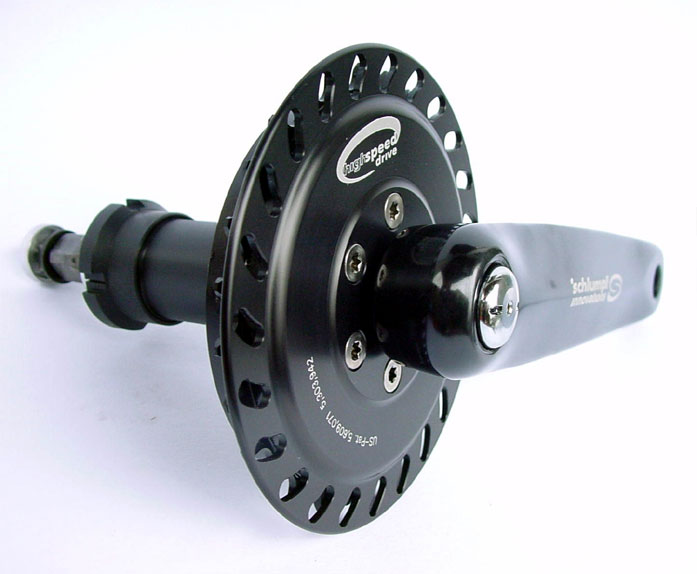

Drive train: Schlumpf high-speed-drive
http://www.schlumpf.ch/hp/hsd/hsd_engl.htm
I must find out if this compatible work with my bike.
Status: Not Ordered Yet

I plan on running a single speed in the rear with a Schlumpf front de-railer which contains an internal gear system for low and high speed.

I have not seen that Schlumpf front de-railer which contains an internal gear system for low and high speed before. Does this mean there is two speeds only or two ranges of high and low speeds? I am guessing its going to be a two speed in total with the single ring on the rear. Not sure how your bike will perform up hills compared to mine as my frame is the same but I have gone with different volt to amp ratio. I am running a 48 volt 20 ah with I believe a 3c rating and my controller is a 35 amp. It is a lithum manganeze pack from samsung that I am running. I have only been out for 4 rides in total as I just completed the bike but I am really liking having the 7 speeds of pedal ratios. When climbing (and I am running a 24" rear wheel and glad its there) I just shift down to keep my pedal speed turning at a nice speed and I mounted my shifter on the left side of the bars so my shifting is not getting in the way of my twist grip throttle. This pedal assist is really cool when riding on any terrain that starts to slow the bike down. Just a bit of pedaling helps a lot. I feel that the few Watts I am putting out just helps bring the motor back into its happy zone being able to spin a bit faster on the climbs, its a great feeling to see the bike respond in this way. The reason I mention this is I would not be able to help my motor out like I like with only two gears to choose from. I have often thought even 2 gears would be just fine if the motor could drive those two gears but not two gears for pedal assist in my opinion .

Fancy pedal drive? why? pedaling a cromotor?
You raise a very valid point. I'm mostly concerned with the initial 20-30km/h of accelerating and off-roading. Do you think I can get away with a single speed setup? I would like to save some $$$!

at 111 volt... with lipo... no you don't need to worry about the acceleration in any band; just consider a human can never ouput even 500w through the pedals. If you are dumping several thousand watts, you are at best adding 10-15%... so drop in the bucket, much easier to squeeze the throttle slightly harder since you will almost certainly have enough torque to just wheely flip the bike from a standstill, and indeed probably up TO the 20-30 range you are talking about. You can definitely deal with a single speed in the rear, lots of people run a triple ring up front with a mid derailer to keep some speeds, but I NEVER pedal my 100v bike. It's really a motorcycle at these power levels you are entering; you will see.

.. You can definitely deal with a single speed in the rear, lots of people run a triple ring up front with a mid derailer to keep some speeds, but I NEVER pedal my 100v bike ...
i can confirm that. even though i have only a 12s setup with 1500w max i almost NEVER use the 9 gears at the hub. i just switch between the front middle gear (for launching) and then after some meters switch to the big one (for cycling), the rear gear's always set to the smallest one.
