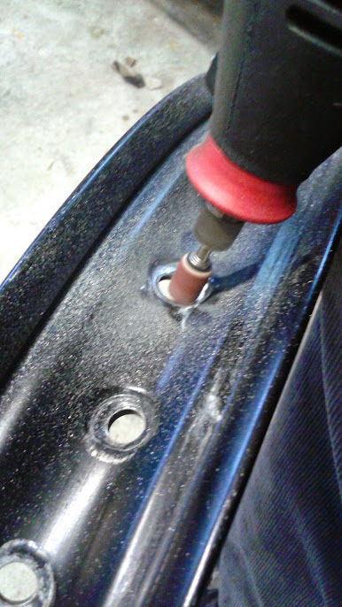

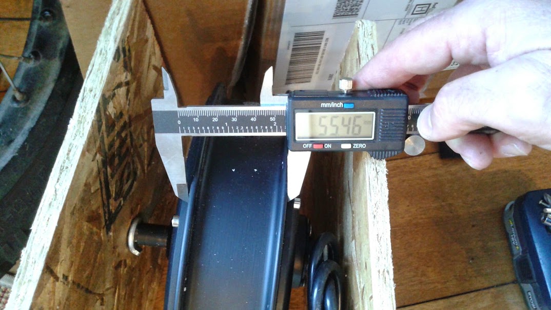

so i could take apart the stromer motor/wheel, fix it and then deal w/ the dropouts, or i could play with something new that just arrived....
gotta say i was a bit alarmed at the shape of the box after shipment:
but how awesome that the motor (right) was stabilized between plywood!
the flange width is nearly identical so why not reuse my old MC wheel and spokes. :mrgreen:

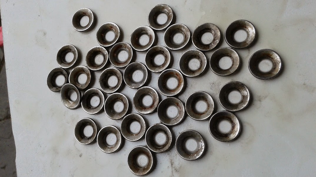

they look a bit nasty...
but after snapping 4 spokes that despite resting overnight w/ WD40, tapping and torch, and some cleanup:
but since we know that "corrosion.never.sleeps" - thanks, len- we can't just leave it like this:
so after not getting far with steel wool, i went dental on it, and ground out the cavities:
i could repaint, but i'm going to hope this will do the job:
along with coating the washers with T9 as well:
of course i should have sent the triangle to heliarc so i wouldn't have to dish it, but i need special tools to take it apart and haven't been able to get to it. as it is, i'll have to spread the frame about 5mm or more for the axle to fit:
but i wouldn't be surprised if this motor ends up in several wheels over its life.
but that reminds me. should i drill it out? it will definitely cook getting to the top of my hill...

Smaller wheel like 17" or 18" especially with new spokes required...
GCinDC   10 GW
Posts: 4244
Joined: Jan 23 2009 11:19am
Location: Washington, DC
Re: GCinDC's Giant DH Comp
Post by GCinDC » Mar 14 2015 10:02am
dbaker wrote:Smaller wheel like 17" or 18" especially with new spokes required...
thank you, voice of reason. :mrgreen:
