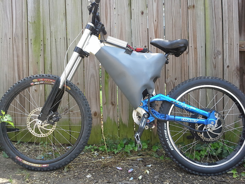

I got the swingarm through a bike shop. I haven't put it on yet, but i'm waiting for my cromotor, which is being laced into a 26" large marge rim with kenda 2.7" tires. The swingarm is for a 05 dh team, but it'll fit my 03 dh comp. I measured up the shock mounts and its EXACTLY the same. The only thing i need to do to confirm this is to actually do the transplant. The 05 swingarm has the 150mm dropouts and doesn't have that weird offset on the right swingarm that the 135 swingarm has. My 5404 is frickin huge and its really stretching out my dropouts. But with the 150, there's plenty of room. In fact, i'll be much more comfortable playing around with spacers to center the wheel. Should be a lot easier. Im not to fond of posting pictures...since i need to resize everything...but i did take one of the swingarm. its BEAUTIFUL. I don't even want to put it on. The metallic blue just looks wicked awesome.
Did a 10 mile trip on a trail in the area...averaging about 30 mph...peaking out at 42mph... :twisted: and i used up 7ah. I was pulling 5kw max...probably 2-3kw continuous. The 5404 was barely warm. ALL USING A 12fet SENSORLESS!!! i reprogrammed it to 50a main/ 100a phase to be conservative...Its a beast. I set of a speed camera too. hahahaha!!! :P
Currently, i have a 16t bmx freewheel from sunlite...i'm using the coveted xtr to provide chain tension. :D I ripped the housing after doing a wheelie and flipping the bike. I REALLY NEED TO GET A REAR DISC MOUNT GOING BEFORE I CONTINUE TO THE SHIT I DO ON THIS BIKE. I'll pay more attention when i get the cromotor. But i did get the derailleur housing replaced...since i ripped it off after wiping. I also ripped some of the hall wires and the phase...still works though!!!
well...this is what got damaged when i flipped...ONLY THIS. FML.
Anyone got a source for good tutorials on how to lengthen wire with good soldering technique?
AGAIN, GORGEOUS COLOR. I just need some red on the bike....then it'll scream AMERICA. :D
The particular angle this picture captures....is IMPOSSIBLE to find. I spent an hour looking for a picture so i could see what shape the arms took. FINALLY. I had to get one myself in order to see. The 135mm has the left arm almost parallel to the frame tubes, while the right arm deviates from the centerline of the bike about 10-15 degree, which makes a weird offset. Whats worse...the left arm is actually a little stiffer than the right because of it's geometry. SO when you try to jam a wide ass motor into it with spacers..you end up just pushing out the RIGHT arm only...which sucks.

Much of my time. I just want a reliable system. What am doing wrong?!!!
Any help would be appreciated. I'll post pics of my harness, bike and controllers.

i've never had a controller pop like that, unless it was loose and shorted! pic of your beast:
i just noticed how your forks extend your wheel base. i like that.

you plugged a 100V battery into a controller with irfb4110s? did any of your previous controllers have the ability to withstand the 125V of the 30s lipo? no precharging resistor to reduce the inductive spike impact on the mosfets?

I definitely have a precharge setup. So my harness connects my 24s4p packs into a single battery plug with a precharge connector (female). The other end has the other precharge connector (male) and the red/black power cables going into the controller. I have been using 24s consistently with all my controllers....even the 12fet. So...in other words...i used the EXACT same setup with my 18fet 4110, 4115, and 12fet 4110. Results:
Same setup...24s4p (99.8v off the charger):
1. 18fet 4110=blew up fets the moment it was connected
2. 18fet 4115=blue phase died at about 1mile doing 2kw
3. 12fet 4110=STILL KICKIN....even hits 5kw and is ABSOLUTELY FINE.

It seems to me that if it works OK with a sensorless controller but doesn't work with a sensored one AND you've screwed up your controller to motor wireing doing wheelies :twisted:, your hall sensor wires or the halls them self are screwed up. Lyen sells a tester for checking them, or you can use a multimeter.

you'd said the motor was in reverse the first time you hooked it up. so obviously you found a setting to go forward, but i wonder if it was the RIGHT one. i've heard you can do false positive settings - ones that work but that are totally anemic. did you research proper lyen controller -> cromotor hall/phase wire combos?
that would explain why it runs sensorless and not sensored.
