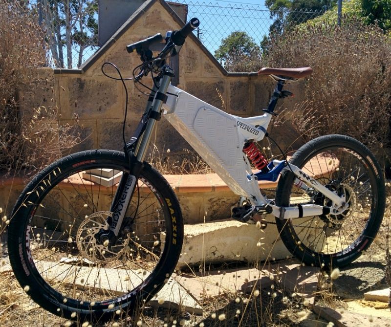

Just thought i should post a thread for my bike, as i have been following endless sphere for a while and randomly posting generally useless information
Nothing very creative in my build except maybe the battery box, which took inspiration from "timma" well the cutting and chopping not the exicution
8t mac, 12 fet 4110 infineon, 15s 15Ah zippy lipo.
2007 Specialized big hit 2, chequer plate box cut into frame to house batteries and controller
The box was a favour and a rush job, not much planning i.e we made it up that morning, but my friend is a first class welder and did a great job with the limited tools, materials and work area we had on hand that day.
A year now and the frame is holding fine, 15s was the secret for fun after running 12s for a while, I can keep up with 50cc mopeds/scooters but blow them away on acceleration, freaks them out! Not sure how long the mac will hold up 40+ amp peaks, but i only go flat out 10% of the time
Bike rides great, i previously fitted the kit to a couple of lighter xc bikes, soon realized i needed a DH/freeride bike.
Not much fun pedaling it without power, but it was not much fun to pedal before the motor

A beautiful build. What thickness of plate in the battery box? Did you have it heat treated?
Growing old is compulsory, Growing up is optional.
Go fast bikes NEED stop fast brakes!
deffx   100 W
Posts: 243
Joined: Feb 07 2013 11:15am
Re: The Blue Beast
Post by deffx » Aug 30 2013 2:03am
G'Day Dawrench
LOL "beautiful" is not how id describe it, practical and great fun is
Its 3mm plate, no heat treatment, No problems so far, I don't really jump higher than a foot if that, but have hammered it somewhat offroading. Its pretty heavy and planted
I was going to get it powder coated which involves going in an oven for a while, kind off a semi heat treatment. But it is going under the knife again, i would like to do a more refined/intergrated tank job.
Carrying a decent battery was my main requirement, it has 30Ah @ 12s or 20Ah @ 15s, thats roughly 1300-1500 Wh

Bottom tube removed, kept half the top one to help keep the angles/length and I think its given it some strength
Was a real rush job at the time, would love to redo it one day' timma style
Great bike though, rock solid at 60 km/h
One idea is to build a complete new front section and have the option Of switching back the original frame to sell or ride. To late for me now though
Look forward to seeing yours

Your not worried about the strength of the frame? Looks exciting if it holds up. How wide is the frame? enough for 6cm lipo?
deffx   100 W
Posts: 243
Re: Bighit 8t mac
Post by deffx » Dec 23 2013 9:23pm
John Bozi wrote:Is that a norco?
Yes an old Norco shore vps 2002
Worried? Hell yeah! I'll get it rolling without a motor and make up some bolt on side covers. Then test it out
Width is 40mm internal at the moment so 4s packs, 10 Ah at 12s should fit

Was worried and checked it alot at the beginning, but i have totally abused this thing for almost a year and no problems
the big hit frame is 2mm ali and the box 3mm ali, its even hard to drill a hole in the box.
This is what was cut out

I was holding off on powder coating thinking I'd redo the box. But as it's proved to be strong I think I will live with it. Ugly as it is. Pretty close to putting together a second bike so this one can be stripped and get painted. For some reason I'm thinking white even though Black's stealthier
Samd   1.21 GW
1.21 GW
Posts: 3667
Joined: Jun 28 2011 11:08pm
Location: Ballarat, AU
Re: Bighit 8t mac
Post by Samd » Jan 21 2014 11:56pm
My fabricator doesn't T6 heat treat any more on his buggies for what it is worth, so I haven't on my frames. The harmonic vibration is much nicer in the untreated frame than my T6 6061 aluminium pub bike - that thing rings like a bell when ridden even with a little Q100 hub.
Most high cost bikes I see now aren't T6 heat treated either. I think times have changed for the better.
I used some matt black plastidip spray on my first frame. All the boy racer types seem to do their bonnets now and peel it off when they change their mind for another colour. I like the rubbery feeling of it - mud brushes off. Worth a try IMHO. it does scratch much easier than powdercoat and peel at edges, but its easy to patch so who cares.
Cheers fella.
