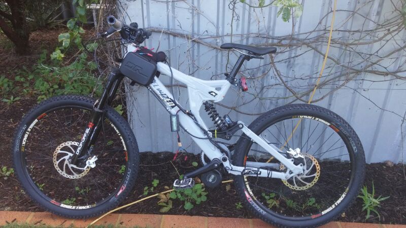

1KW wrote:Pic of big hit with bbs? How do you like it
Image]
Haven't really done allot of km's, to give you my final verdict
Recently did some programming which much improved it
Also fitted a twist throttle, after using a left hand thumb throttle for a while, which was just not natural, love the weight distribution, liking the pas function, it can sip amps
I need to work out a battery configuration and mounting to finalize it, probably chop the frame up at some stage
The big question is how robust and reliable these bbs02's are, we will see
To be continued....................... Lol
