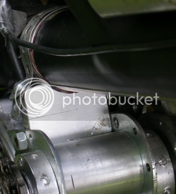

Some photos of my first build in testing phase. Need to finish the bat. box and a bit of the cosmetics.
About as tight a bb you can fit in a triple ring setup.

speedmd wrote:GNG1 #25, 12/72 primary stage chain drive mod. Home made eccentric jack shaft bearing structure with aluminum sprocket and freewheel hubs.
Definitely curious about that. That's a very clean chain drive modification.

My goal was to eliminate the need for idlers and have infinite adjustment on both chains. Not original, and much like a few of the current eccentric BB bearing cup setups. Thought I lucked out, but I will need to add something to the secondary chain side as it develops slop much quicker than the other side. (bike chains suck) I think I can still get this to work with a bit of adjustment in the BB side steel motor mount by bagging out the screw holes just a bit and adding a torque rod to help tighten and also keep it in place. I have a better way for a conventional bb shell, but not enough room on the cdale for it. The top (down tube) frame mount is also something I will upgrade with a solid machined alloy block that wraps part way around the tube and spaced / bolted solid between the jack shaft mounting plates. This will help stop the torque pulling the secondary side to the right when putting gobs of juice into it.
As you can see on the last photo I posted, there is just a smidge of clearance at the 13t freewheel hub shaft / crank arm. This is after I shortened the shaft some 4 mm, and put the rings in as close as I could to clear the 53 tooth ring on the rear stay and not have the final drive chain try to climb on top of the 56 tooth secondary ring / chain. I wanted it to pedal more like a road bike and did not want to go with a wide BB.

Keep an eye on that 2nd chain. Unless the picture angle is off the 2 sprockets don't appear to be in alignment. That would explain your chain troubles there. Side loads have caused some freewheel failures, and the last thing you want is instantly going from freewheeling cranks to must pedal at full rpm. This potential has prevented me from any builds where motor power runs through freewheeling cranks. A freewheel with dual sets of bearings would mitigate much of the risk.

Good to hear from you. It is not perfect for certain and the wide angle photo/adjustment has some issues also. Agree it is a bad situation having opposing freewheels and trying to hold alignments. When all snugged up correctly (It was a bit over rotated on the secondary side in the picture), it clearly is angled one way when resting and the opposite when power is on it. The top (hose clamp) mount is a joke also at holding the alignment and hesitate greatly on hoping this up any more than it is. The eccentric also can be played with a bit too much and can knock the alignment out if your not careful. I left a bit of extra metal on the 13 tooth freewheel hub as it is easier to take some off than to add metal and all the threaded freewheel parts are not quite fully seated in yet. This all will hopefully get sorted out in the coming miles/ if becomes a issue.
The bike chain is measurably stretching much faster than the 1/4 inch #25 chain. Understandably the 1/2 inch bike chain has much more tension on it and fewer / lighter links. If I had to do it over again I would put a free wheel hub on the larger primary sprocket and go to a gocart chain / sprockets on the secondary. I may end up doing just that at some point. For now it is just a commuter I can hopefully have some fun riding and learn some with it.

Update on secondary chain slacking. I have been testing this setup daily and finding that the top/front clamp (hose clamp is allowing the front end of the motor assembly to move to the right too much under power) is what is causing most of the adjustment issues with the secondary chain. Thinking now, it is the weak link in chain alignment/ tension issues with this kit. Will post a picture/update as soon as I have a chance to come up / install a good fix for this.

Made a new experimental front mount. Much stiffer and torque transfer to the wheel in much stronger and more sudden now. I can push on the front end (on the hub of the 13T freewheel) with my foot and feel no sideways movement at all. None visible via the motor torque either. I used 1/2 x 1-1/2 x 2 inch aluminum bar and cradled /nested the down tube into the top face of it. Very please with it so far. Clamp setup just a temporary solution for testing it out. Image
Battery box getting close. Cover snaps in and stays put reasonably well. Need to come up with some type of latches before I start to mess with the top finish coats.
