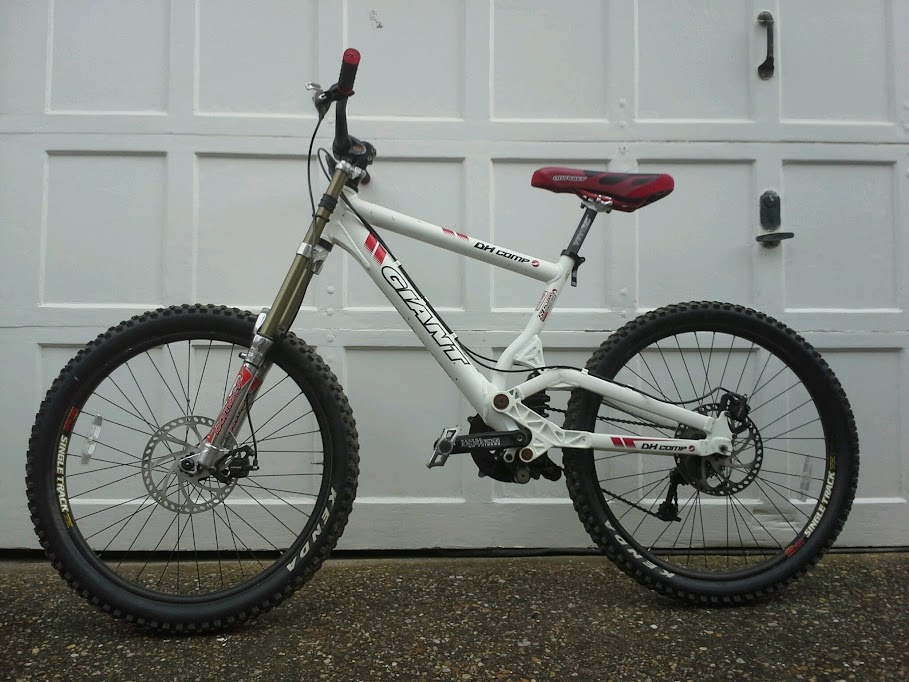

2002 Giant DH Comp, before:
After:
Specs:
- kiwi's DH Comp Dropout Adapter
- Adaptto Mini-E Controller + Display (no BMS yet) - 6kW max
- 20s2p Turnigy 20C lipo (10Ah) in custom frame/bag
- vented hs3580 in 19" x 1.85" MC wheel with Shinko 244 tire
- Half Twist throttle
- 7spd 11T-32?T freewheel, shifter flipped and installed on left grip

The good news and the bad news !!
The good news: :D :D
I came back yesterday night home after a trip for my work.
So I decided to set the new tire.
Done, so I went for a ride to test it.
I had 28% left.
The bad news: :shock:
I turn the throttle but the bike did not really started I usual.
The e-mini shows "low battery", it was still 28%, but 45V !
The batteries are dead ! :( :(
I left the bike Saturday with 75V and the batteries were unplugged.

du calm. this is a time to be rational.
forget about the minie for a second. use a multimeter and tell me the voltage of the pack, not connected to the bike. measure across big red and big black (not precharge)..
gimme the number.

And just for the record (and the benefit of the community), if i understand correctly, you plugged the battery into the charge port (charge GND and main + leads) and rode the bike. You noticed that it had less power than normal. (I didn't know it was possible). I'm very curious what the display showed at this time; did it show negative amps, as if charging?
and you must have drained the pack to 55V (2.75V/cell) during this ride, right? because you said you left the battery disconnected from the controller before your trip, right?
no shame in it! just another lesson learned! :wink:

why doesn't the BMS shut down the controller at the 2.7V level? there must be some sorta voltmeter on the display that reads out the pack voltage too so there is time to shut down when it gets to the 62V level or did this just drain down over the weekend while the controller was left on? it should still shut off at LVC even if unattended.
GCinDC   10 GW
Posts: 4244
Joined: Jan 23 2009 11:19am
Location: Washington, DC
Re: Axel's Giant DH Comp
Post by GCinDC » Apr 25 2014 10:13am
dnmun wrote:why doesn't the BMS shut down the controller at the 2.7V level?
no BMS yet.
but under main menu > BMS Setup there is a Low Voltage Discharge Cutoff. I wonder what it's set to! Axel, can you check?
I assumed it didn't think it was discharging because it was attached to charge port, but don't know. Good question..
Youtube channel, 2013 Highlights vid. Ebike Nerdcast.
Giant DH Comp: 20s lipo (11.6Ah), hs3540, Adaptto Mini-E, 900W BMSBattery charger.
GT I-Drive (sold), 20s lipo, 9C, 72V 45A 12FET.
dnmun   100 GW
Posts: 16190
Joined: Jun 09 2008 1:32pm
Post by dnmun » Apr 25 2014 10:36am
ok, charger drained it down through the charging port while the charger was off. that is not much current. about 56V/5k6R or about 10 mA so it should not damage it discharging at that rate. we just don't know if one of the cells got lower than 2.7 while it was in use.
hoping the voltmeter is inaccurate too.

here's a pic w/ serialized batt connectors plugged into discharge leads. axel had disconnected these and then when he reconnected, he plugged in the single + lead and attached the precharge + and GND connectors to the charge leads shown at bottom:

so it could be draining through the precharge resistor.

exactly, and I did a very short ride close to my house
It was so short that I did not look well at the display, just remember 28%
I unplugged every thing and 3 days after, I set-up the new tire, plugged the batteries, saw 28%, but when I used the throttle, I had no power !
But Greg when I rode it with batteries into the charge port, it has not less power, it has more power at the beginning (in eco mode) and it was cutting the power for millisecond. I bought at this time that I did a wrong set-up in the mini-E
