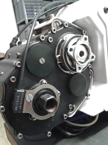

Hello to all of the readers of this thread, I'm the proud new owner from Italy of this wonderful Stealth Bomber. As was suggested by Allex I will continue this thread by adding the changes that I will feel appropriate to make.

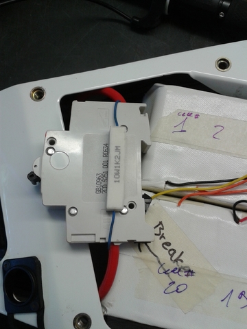

First of all I have installed a 1,2KΩ 10W pre charge resistor between the breaker contacts, I’m going to let that resistor always there. I know that is not needed but I wanted to try anyway. These days the breaker is OFF and I’ve been checking on a daily base the voltage of the cells and I have not yet had a significant voltage drop. Nothing changed from few days.

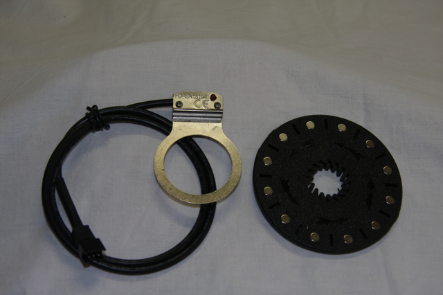

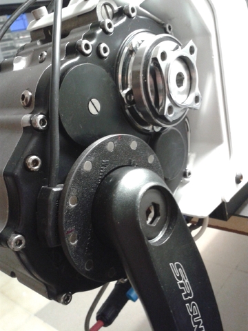

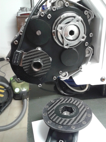

Also I have installed a PAS System on the right side of the V-Boxx. This is not a straight forward operation because the PAS is designed for a standard bike.
This is the PAS as delivered from this e-bike seller: http://www.alcedoitalia.it/shop/accesso ... rettyPhoto

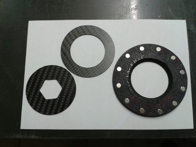

On the late I have reduced the outer diameter and enlarged the inner diameter of the PAS disk and made two carbon fiber 1mm thicknes disks that are fitted as in the following pictures.
The main problem is the little gap that remains between the pedal crank and V-Boxx after tightening the pedal crank. It's 1mm on the right side. The PAS disk is 4mm thickness so I have made the little carbon disc with an hexagon in the center and decided to mount the PAS disk on the hub pedal crank. At the end I needed some more play between the PAS disk and the sensor so I have made the bigger carbon disk. I was enough lucky to have made a small interference between the hub of the crank arm and the inner hole of the PAS disc to have a mounting stack of the 3 discs. Tightening the screw everything is packed and it allows me to install everything without glue between the discs or screws.
The carbon discs are crap made but I wanted to be as fast as possible and made them with my hands.

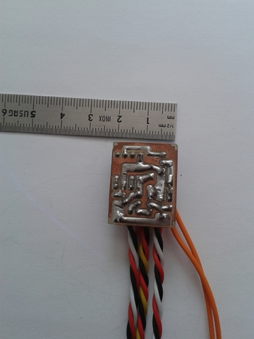

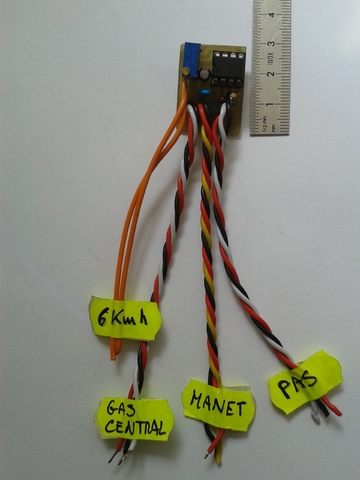

Also I bought a small circuit where I will plugs the Throttle, the PAS and the wires from the Adaptto display, this circuit is called Gas Legalize and is made by an Italian e-biker. It will connect +5V to the Throttle only while the pedals are spinning.

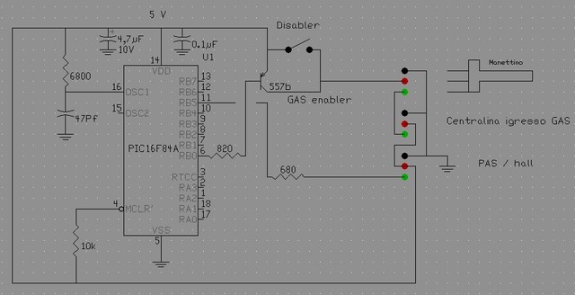

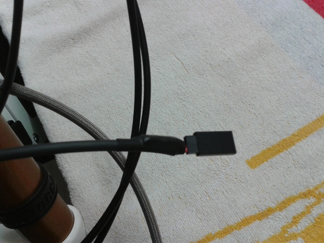

This morning I got the circuit to use with the PAS.
This is roughly the schematic, the builder made some modifications at the final review.

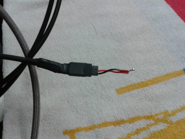

There is the possibility to close the contact labeled Disabler in the pic and doing that the Throttle is connected to +5V as it is before adding the circuit.
This is the circuit, it's very little (MANET is the Throttle input):
The builder added the feature called 6Km/h that override the PAS. Connecting together the orange wires with a switch it allows to ride the e-bike at a very low speed with out twisting the throttle for few seconds. It was introduced to move the e-bike up to a ramp just outside the garage for example.
The next days I will install the circuit inside the frame and I hope everything will work as expected. :D

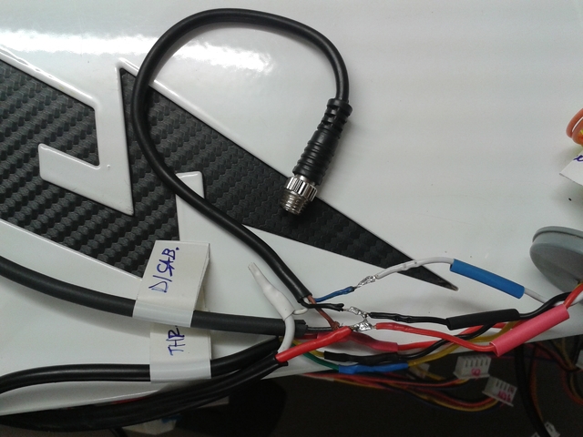

The great news is that PAS WORKS :D
PAS circuit mounting:

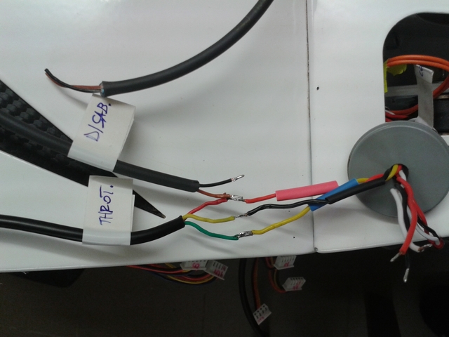

These are the new connections needed to use the Gas Legalize (GL) circuit.
Throttle is connected in the following way (to MANET in the picture above): Throttle +5V red to red input wire on GL, Throttle (-) yellow to black input wire on GL and Throttle green signal to yellow input wire on GL. There is also one wire of the disenabling two wires cable soldered on the red +5V.
The 4 wires cable coming from the Adaptto display is connected in the following way (to GAS CENTRAL in the picture above): Adaptto black (-) to black input wire on GL, Adaptto brown +5V to red input wire on GL and Adaptto blu signal to white input wire on GL. The other wire of the disenabling two wires cable is soldered on the red input wire on GL too and the regen brake is the same as before.
This is what I made to close the contact on the disenabling two wires cable (I will use a jumper):
This way PAS work:
This way the PAS is disabled and I can use the Throttle as it is standard on the Bomber:
On the e-bike PAS Disabled:
On the e-bike PAS Enabled:
