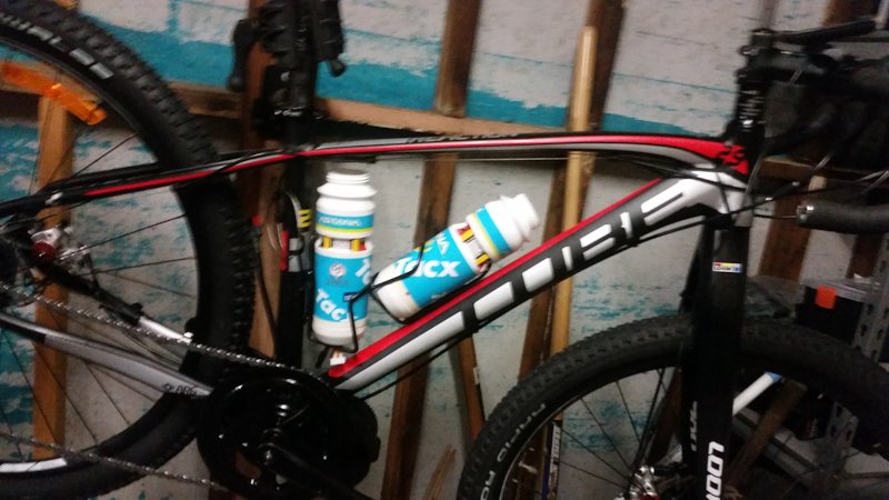

The original plan of hiding the batteries in drink bottles didnt work out(although would have been mad stealth). I actually had it working for a month while testing but I didn't have confidence that the bottle holders were strong/safe enough for holding lipo's. I even tried duct taping the thing down... The weight of the batteries inside the drink bottle kept on moving it around. It was a safety issue... So I went back to a formula I know works well. Metal box out of building frame metal and hose clamps. I'll revisit the water bottle idea later if I have time. The issue was the holder not strapping the water bottle tight. If I had better knowledge of 3d printing, I'd build some custom mounts and make it work.

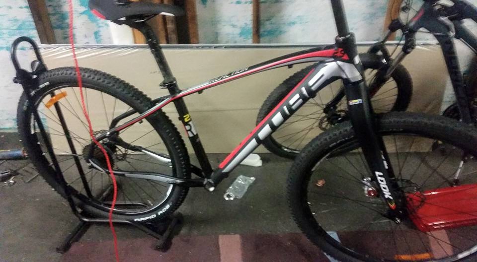

Update test fit :

It's too fast, I need to tune this thing down (was doing 70km/h on the speedo while on the bike hand on throttle). PAS 1 is too fast as well... and I never liked PAS anyway. I'm going to need to disable it and just use throttle for now while I read up on BBS02 programming.
Next is to integrate battery stealth mode (next weekend).

I'm running a 48t front and 9 speed 11/34 rear for mega range. It's an MTB cassette and deraileur (has more clearance for larger cassettes). The 9 speed shimano road shifter seems to work with 9 speed and down MTB parts (interchangable). The 10 speed an up is where the pull ratio's change (10 speed MTB wont work with 10 speed Road). That's why I had to go with the Shimano Sora shifters. Trying to find a 9 speed 105 or ultegra was impossible and I didnt want to tear apart my carbon roadie =/ The newer Sora shifters are quite nice however... I'd rate it close to my 2010 model ultegra shifters.
If you're wondering why I had to cut the bottles in the middle... It's because 7S lipo is too fat for the crease part. Would probably be fine with 5S lipo or maybe one of those tool bottle things with the single indent. Those are the $1 750ml drink bottles from when catch of the day had a sale on ebay... Only managed to pick up 2 at the time =(...

Thats awesome man. Asia is cool- they may have had wars etc, but seems to me it's the oldest culture on this blu ball. Cool people. Hope you get a chance to really enjoy it!
Also, the waterbottles are as stealth as it gets without doing round cells in the frame- I like!

As with anything on an ebike... there's always the colour option of duct tape black for the water bottles =)
The water bottle cages I have are really weak for side movement. They cant hold on to the weight of the battery over bumps, so I'm looking for a more "enclosed" design.
Thinking one of these :
http://www.ebay.com.au/itm/Glass-Carbon ... 2a5395d2f8
Because there seem mounting holes in the middle so I can slide the bottle cage up/down

Charging solution - Charge cables come out of the top of the bottle. To charge I just unscrew to the water bottle to show the cables.

While rebuilding the controller and waiting for parts... I converted my 29er cyclocross back to a normal bike... It's a dream to ride even without a motor. Stoked with the results of my custom build (good on the road and the sandy / dirt trails along beach roads). Did 80km ride last weekend down to Frankston South along the beach to clear the mind and start re-training after my accident.
Yes seat is a bit low in the pic, I upped it after this pic to reduce stress on my knees.
