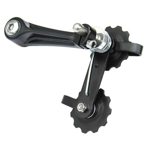

I'm looking at a chain tensioner now. Something like this should allow all the chainrings to work.
https://www.ebay.com.au/itm/MTB-Bicycle ... 2417137303
The smallest chainring will have a lot of slap, but it's only going to be needed in a slow going get me home mode anyway, so no issues with that.
The 2 speed is the Schlumpf drive, otherwise known as the ATS speed drive. I have one on my recumbent (and my Fighter). They are great units, and I would love to put one on the Alpha, but at $650 a pop installed, the price is a bit hard to swallow. If I find even the 60T too slow for my liking I might consider another Schlumpf for the Alpha.
It's worth mentioning, I plan to run 3 chainrings up front (just bought a 38T last night). I will manually change the chain over between them as needed. In the rear I plan to run a 12T freewheel.
Any recommendations for a good quality 12T for the rear?

CD, you need the Paul components Melvin chain tensioner. https://paulcomp.com/shop/components/me ... tensioner/
I am running this on my Beta and have had it for over 10 years total on various bikes and Ebike builds. This is the 3rd ebike I have had it on. This mounts directly to the deraileaur hanger, and to shim it for free wheel alignment, all you have to do is move the aluminum spacers around, and maybe a washer or to for perfect alignment. To boot, there is enough chain wrap slack to provide chain tension for up to 20t differences on the front chain rings. So you could get a way with running a 36, 44, and 52 toot up front, or if you use your 60T sprocket, you could also run a 40T as your smallest sprocket. I personally would not run a chain ring on any ebike bigger than 52T because of ground clearance concerns riding off road. But thats just me. I am running a 36/52 sprocket/chain ring combo on my Beta and a 16T free wheel. I call this the poormans Schlumpf :lol: and have pictures posted of it somewhere on this thread. I can pedal assist easily with a fairly conservative cadence at 20mph and on the 52, and when I start climbing anything north of 8% grade, I use my finger to move the chain down to the 36T. Anyway food for thought.

Thanks Rick.
I ordered this one already.
https://www.cyclingdeal.com.au/buy/bike ... ack/MT-95D
I will give it a try and see how it goes. No idea what the tooth difference it works with, but will try it anyway and see how I go.
Failing that I might try the Melvin. Thanks for the suggestion.

Looking at this, if it doesn't work, the Melvin may not either for your needs. With the arm, you should get at least the range one would get with the Melvin. Be that as it may, I look forward to your build progress.

I'm really enjoying the 500w geared mxus beta I put together. I put it through its paces last weekend, and have discovered that it needs a tensioner / chain guide. I'll try and get one to go around the front sprocket. It appears you can get bolt hole brackets that use the BB to be secured in place, allowing for a chain tensioner / guide to be bolted onto the bike. This will be the cleanest approach, id say.
I am using a low end sunrace deraileur and could probably upgrade to one of these clutch type units for a bit more tension too.
I'm running 8speed, but would probably recommend going 7 in the future.
